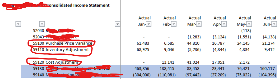

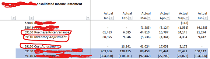

Hello Everyone,
My accounting team gives me a monthly income statement and asks me to explain the three accounts below. (Why did this amount come out?)
  1. Purchase Price Variance 2. Inventory Adjustment 3. Cost adjustment
I know what those three accounts are. However, my problem is that when I calculate the monthly amount from the raw data I found through POs and transaction history, it does not match this Income statement.
Where can I see the raw data for these three accounts in this Income statement?
I would like to know which POs or Receipts generated the PPV on this report and which adjustments generated the Inventoty/Cost Adjustment amounts on this report. Specifically, it must match this monthly amount.
Please help.

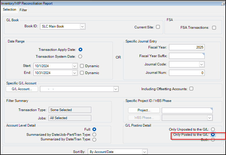

Try running the Inventory/WIP Reconciliation report for the period in question. Go to the filter tab and and filter on those transaction types.
Select the “Only Posted to GL” option
If you cannot reconcile to the accounts exactly, I would suggest using the Specific G/L Account filter and leaving the transaction type filters open in case a transaction type you aren’t expecting is hitting your account.

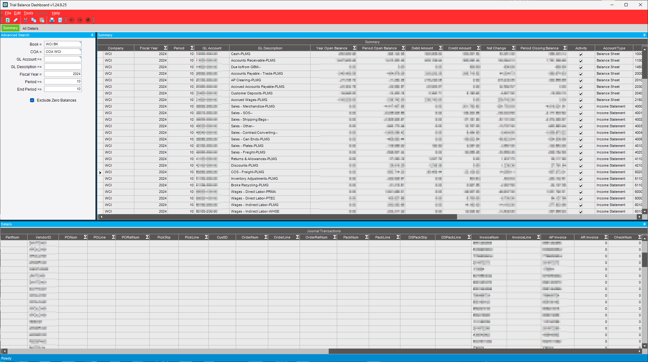

We built a Trial Balance Dashboard that brings all the beauty of Chart Tracker on a Mass Scale to a Dashboard, mainly PartTran/TranGLC/GLJrnDtl. Even Epicor’s Chart Tracker doesn’t have all the links. Using the Chart Tracker, has to be done one GL Account at a time.
Utah is right, the answer is always BAQ when it comes to “ease”.
PS: Getting this to perform fast, wasn’t easy due to backflush

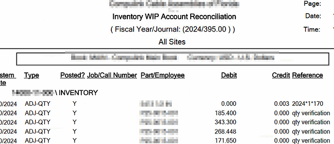

Run the General Ledger Report for the account. I am using our ppv account.
Get the Journal code and Seq from the transaction.
If it PJ you have the data, If it is IJ then you use the wip recon
use the right side for the journal code and Num
Gives you the details of the JE

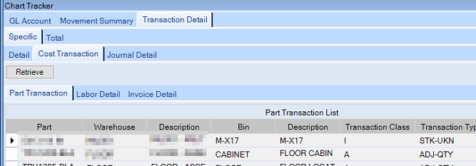

Chart Tracker also gets you to the wip recon details. It takes some practice learning to move from left to right to get more details, but it goes from the journal to Part Tran in one screen.
And yes @utaylor I also have some dashboards that will do chart tracker for an entire period when you are looking the the needle in the haystack.

Thanks, I found data in Chart Tracker that matches the amounts from the accounting team.
One thing that is unfortunate is that Chart Tracker does not have PO numbers or Pack numbers that generate PPV.
Your dashboard seems like the great report I’m looking for.
This may be a rude request, but could you share the source for this BQA or dashboard?
