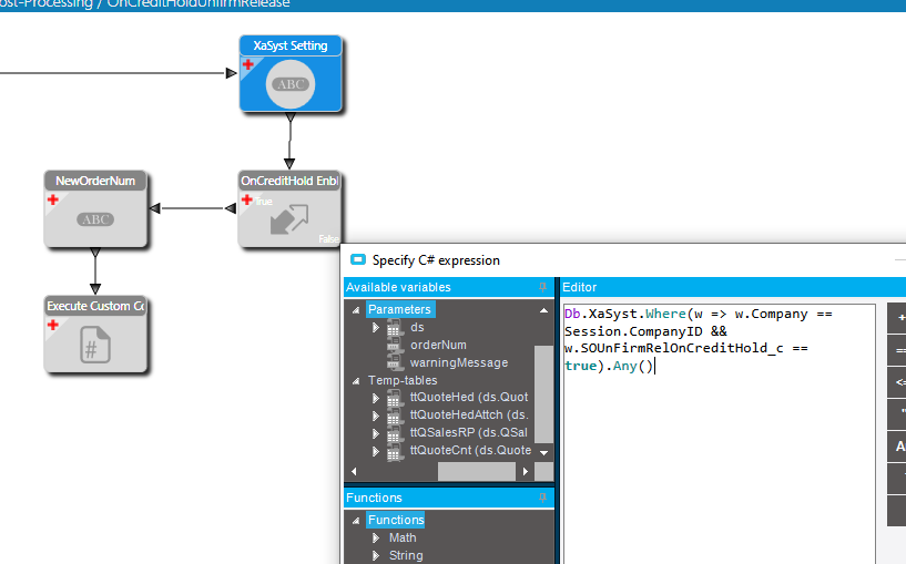

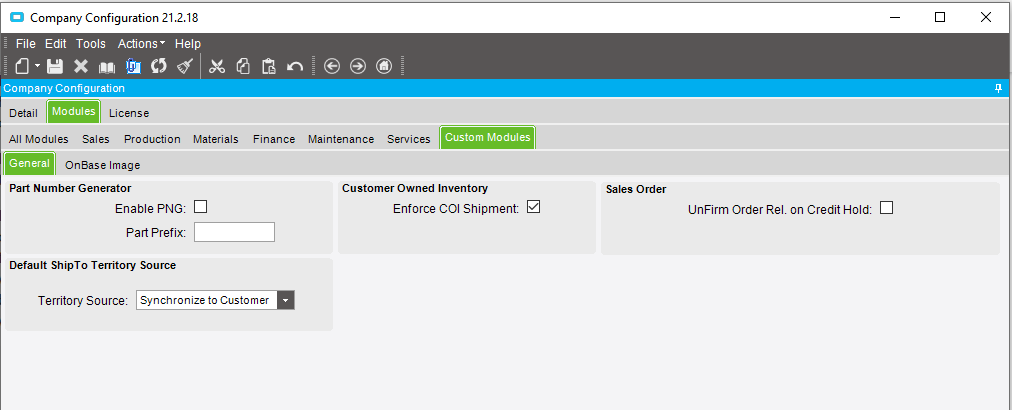

UD fields on the company table have served me well for this. Allows you to store things like API keys there instead of hard coding
