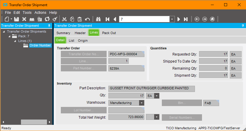

This is the classic “This doesn’t make any sense, but I’ll try it anyway because I want this to work.” Et voila.
The job receipt (which is really the shipment) appears to have created transfer pack #7 and tied it to TO # PDC-MFG-000004 *
And then I must have received against pack 7. (This was a month ago, so I’m a little fuzzy.)
Again, it’s best to think of the job receipt as a transfer shipment. That’s why quantities do not double.
As to your idea, the only thing I could see is two jobs, one in each plant. I.e. MFG-PLT, then PLT-MTL, and then MFG-CUS, and the second job has one line of material, itself again. Sounds like a lot of work, though.

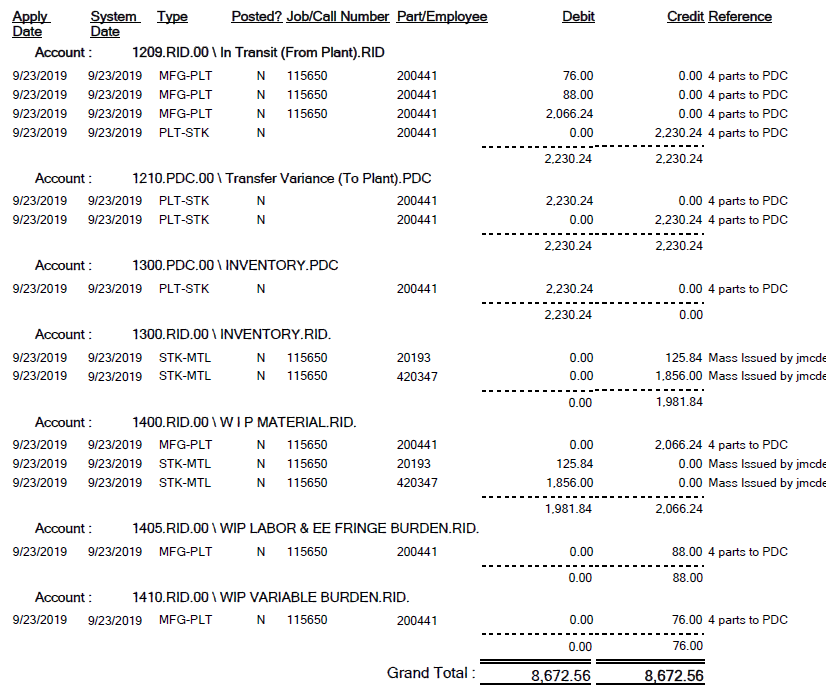

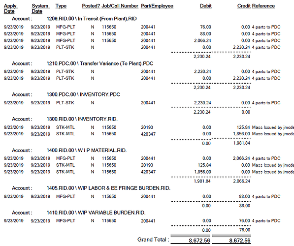

The normal flow (with the GL’s hit) would be:
Business Process TranType GL Debited GL Credited
Issue Mtl to Job At Site A STK-MTL WIP-A INV-A
Receive Job to Stock A MFG-STK FG-A WIP-A
TO Shipment from A to B STK-PLT In-Tran FG-A
TO Receipt at B PLT-STK FG-B In-Tran
Shipment to Cust from B STK-CUS AR Accrual FG-B
Does your method combine some of those? Since your part isn’t QtyBearing at A, it can’t have any ‘STK’ tran types (for plant A).
So MFG-STK combines with STK-PLT, for a single MFG-PLT transaction? Which also automatically creates a TO shipment (and magically matches up with the prior Transfer Order)?
And yes to all of that. Just verified it again with this experiment.
EDIT - FYI, the reference “4 parts to PDC” was my comment on the job receipt to “inventory,” so it carries through all of those transactions, apparently, even though the transfer receipt was a separate transaction that I manually did.
