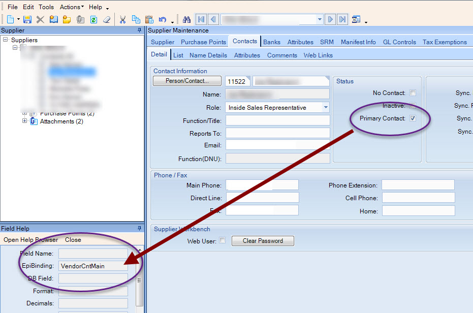

It would appear the Vendor.PrimPCon lists the VendorCnt.ConNum of the contact who has the box checked. Ex: If the Contact for which the Primary Contact box checked is ‘3’ (Value of VendorCnt.ConNum) then Vendor.PrimPCon will return 3.
Further fun: Vendor.PrimPCon will return 0 (zero) if no contact is flagged as the Primary Contact.

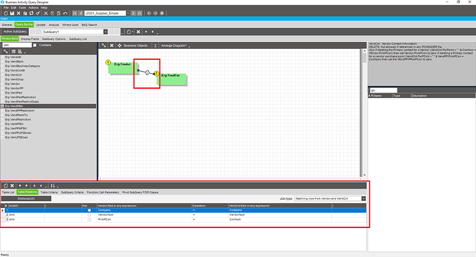

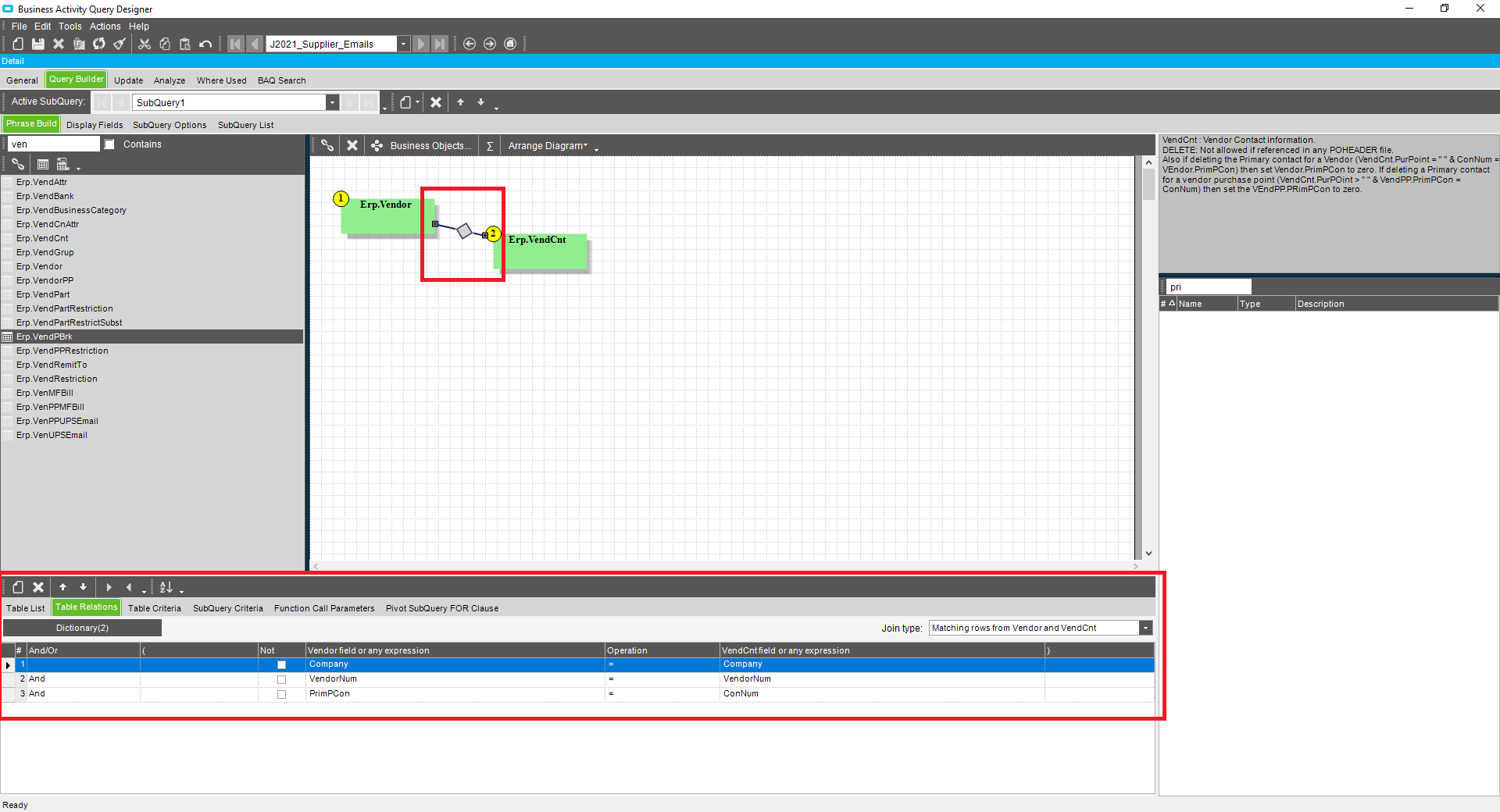

For those who dabble in queries but can’t read SQL code, I’ve attached a picture of a join I’ve done in a BAQ. The result pulls a table of all the primary contacts.
