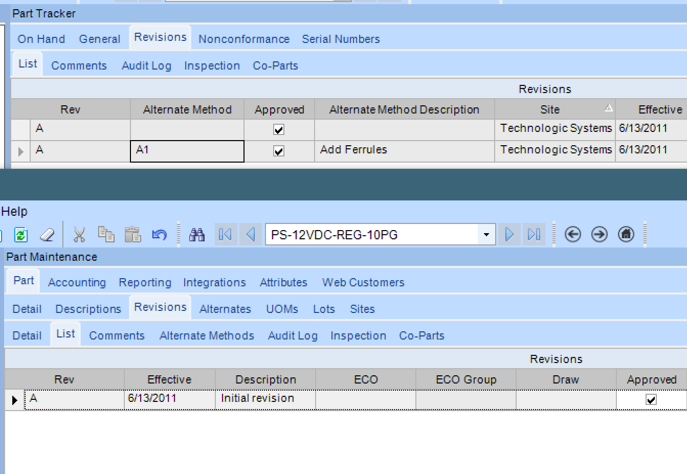

I need to unapprove an alternate method of manufacture for a part. I see it listed in part tracker list view, but it’s not listed in part entry list view. I’ve hunted around through the part entry menus and can’t figure out how to unapprove an alternate method of manufacture(see screenshot below). Can someone point me in the right direction?

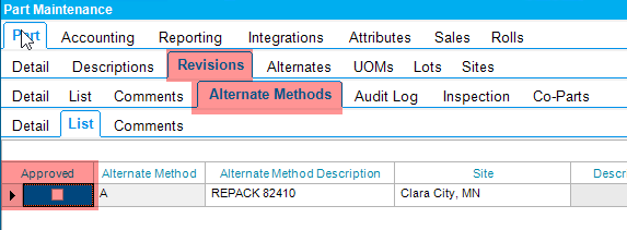

There is a revision field that is not exposed in the Alternate Method grid in part entry. If you expose it with a personalization or customization you can unapprove alternate methods.
Otherwise, you will need to check it out to the EWB and it will carry the primary revision. You can uncheck the alternate method and check it back in at that point.
