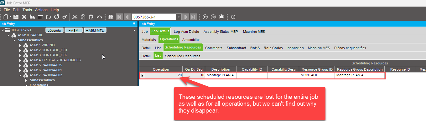

Our problem is mainly that our resource groups disappear on all the operations of a job after there is a change. Is it normal that the resource groups disappear and that we have to re-schedule after a change in the job?

However, we lose the scheduled resources and not the resource groups.

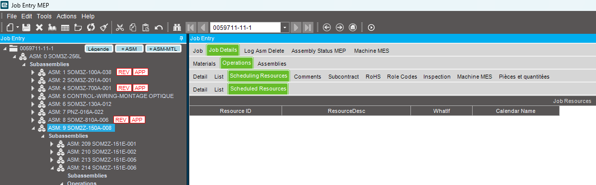

Can you also provide a screen shot of what is lost?

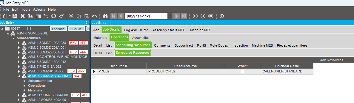

Expand the tree view on your screen shot in your example above.
Does anything show there.

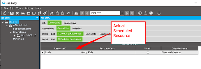

The screencap I gave was from a consultant. There’s nothing else in that tree. It was a fake job. In general, it will show 2 resource lines under the operation itself, one for an operator and one for a machine. But when you drill into the scheduled resources, it will show nothing is actually scheduled and prevent an operator from clocking in via MES. Despite not actually being scheduled, the job itself will still show a scheduled due date on the main job entry like everything is peachy keen and perfect. It’s super frustrating.

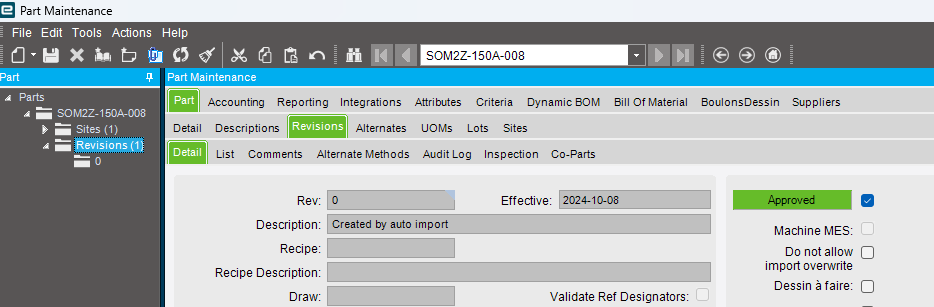

Does SOM2Z-150A-008 have an approved revision?
yes, there is an approved 0 revision

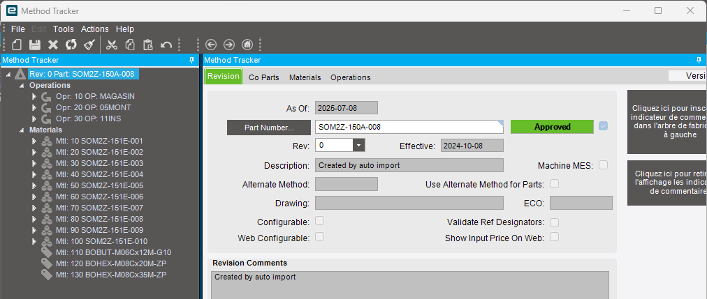

Is that the revision that is on the Job? Is there a method for that revision?
The answer is yes to both questions. The revision on assembly in the job is 0 and we have a method in the Method Tracker.
