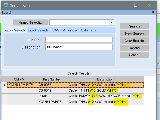

With the BPM enabled, a search for #12 white yields:
if the BPM is disabled, that search return nothing.

This is a great start. It does exactly what we thought it would do with a #12 white search…
I am hoping to go a step further, now. I believe this forces us to enter the search terms in the order that they appear in the description. Essentially, our search criteria ends up looking like:
WHERE Part.PartDescription LIKE '%#12%WHITE%'
so it’s looking for #12 to appear in any position with white in any position after it.
Any thoughts on how we might trick it to search for either in any position?
