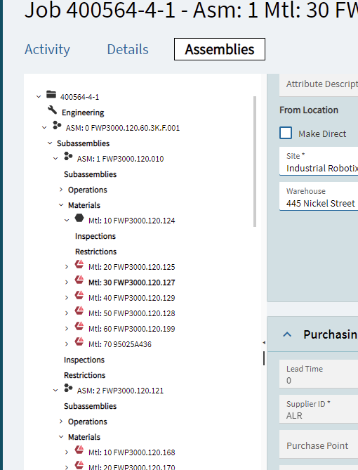

Assembly item. Has sub assemblies, each with a part (which is an assembly with a raw material part, quantity and method). When I generate suggestions and new PO suggestions all I get are top level items. No raw material from any of the sub assembly items. Why? Extremely complicated and frustrating just to create a bom to order materials lol. I have yet another job that is now already late because I cannot order material.

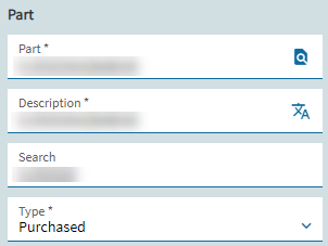

It sounds like your parts may not be set as Purchased. Open up part entry for one of them and check the Type that is assigned.
Thanks. Yes they’re marked purchased.
My structure is as follows:
Part xxx.xxx.xxx is a manufactured part that uses 14" part xxx.yyy.zzz that is purchased raw material and I’ve set up a MOM with various manufacturing methods such as waterjet, saw cut etc
Part xxx.xxx.xxx is used in a main assembly, so I included it in the bom for that assembly as a sub assembly, typically a weldment.
The top level parts for the assembly that are not manufactured such as hardware etc all show up on the po suggestions report, none of the raw material items above in the sub assembly weldments show up.
Is there something I am missing in the job, or in the engineering workbench for that assembly?
