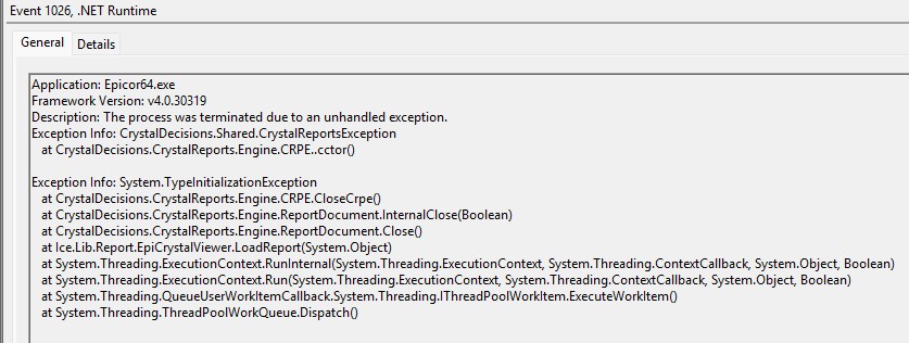

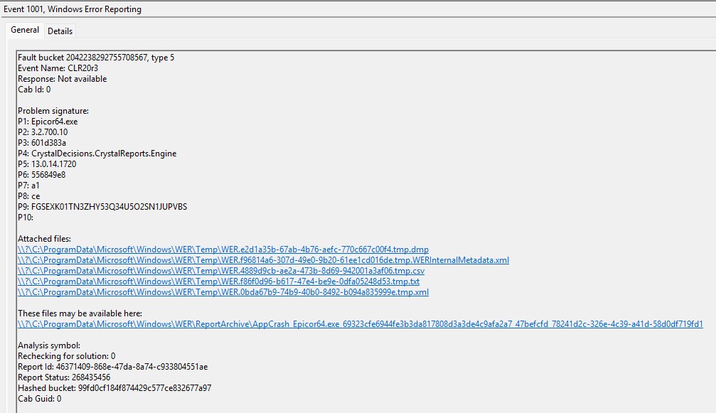

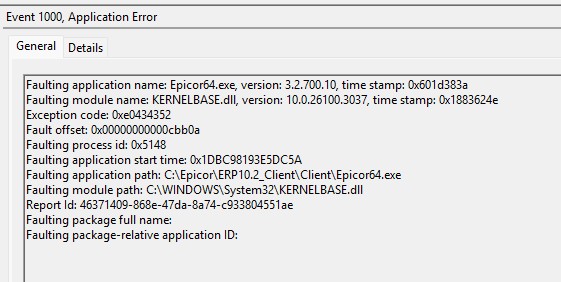

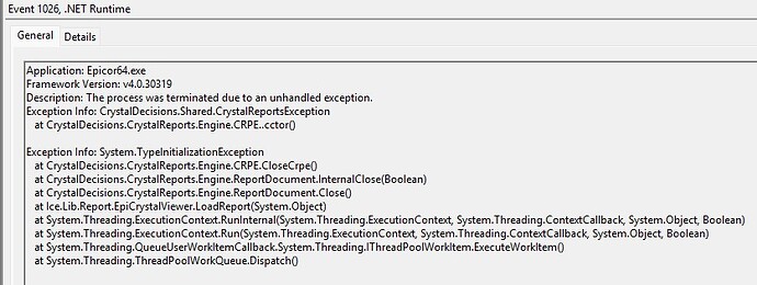

as an update, these are the errors showing under the Windows Event Viewer; not sure what I’m looking here…
SideBySide

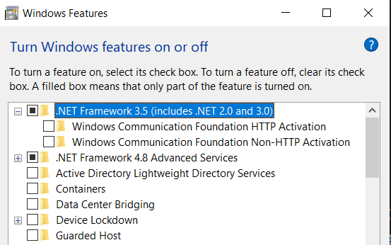

Mr. Moreno: Please verify that the DotNet 3.5 is enabled on your Windows 11 machine. I believe by default DotNet 3.5 is NOT installed.
DaveO
Correct. It’s not anymore.
its installed and enabled
