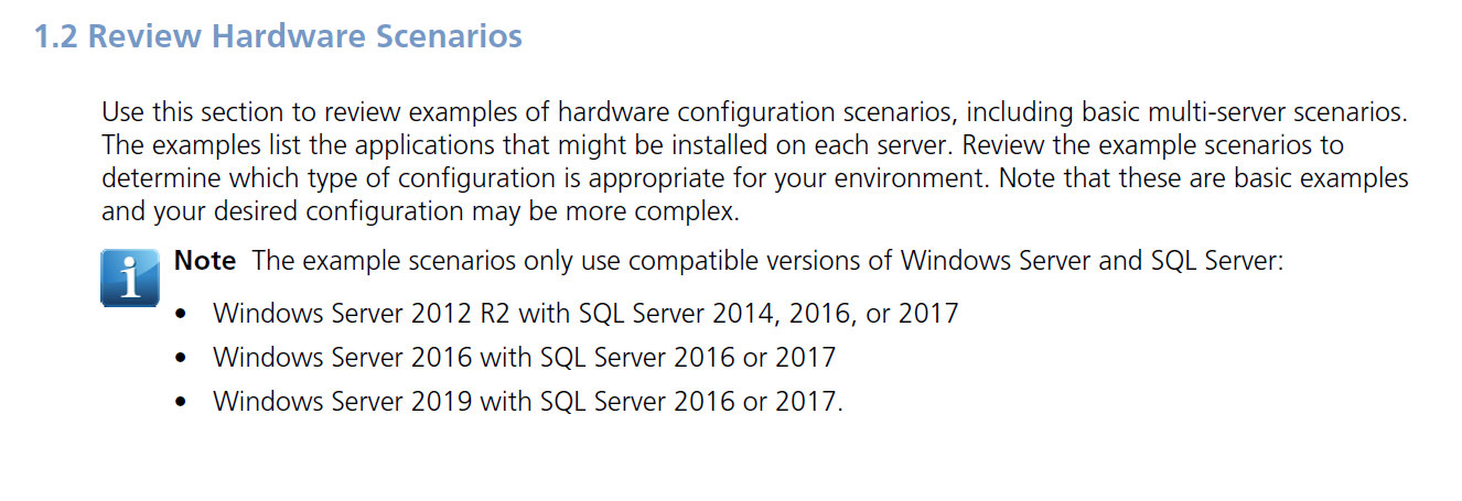

Just a FYI. Looks like SQL 2019 didn’t make it in for .600 according to the hardware guide. I’m working on a new .600 environment so I grabbed the latest docs. Still only SQL 2017. I’m guessing SQL 2019 will be added for .700.
EDIT - In the new install guide it lists SQL 2019. So guessing it is supported? Odd they didn’t update the hardware guide to reflect that.
