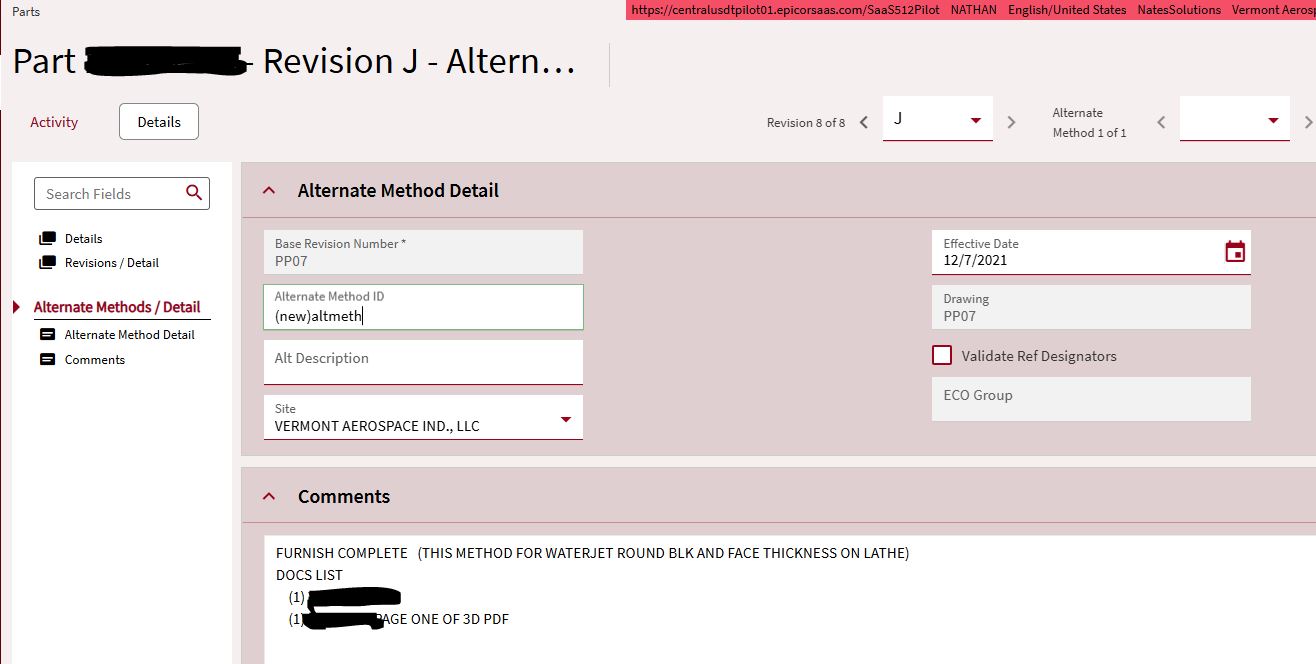

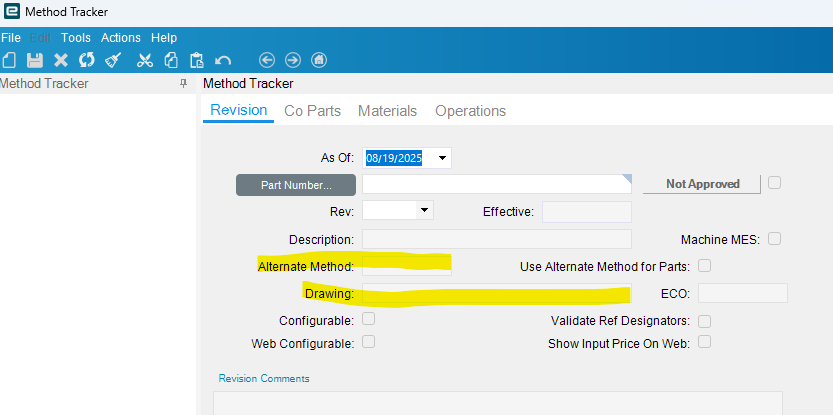

It looks like DrawNum is only at the PartRev level. What if we have different drawing nums for the alt methods? For example, we have a different drawing number for the part when it is made via casting rather than hog-out.
These fields are available for both the blank Alt Method and the Alt Method
When I create a new Alt Method in Kinetic for a revision, I can’t set the draw num. Seems it is disabled and set via the rev.
Forgot about that. Since the functionality is for different routings at sites it assumes it is the same drawing, just an alternate way to manufacture it.

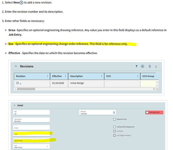

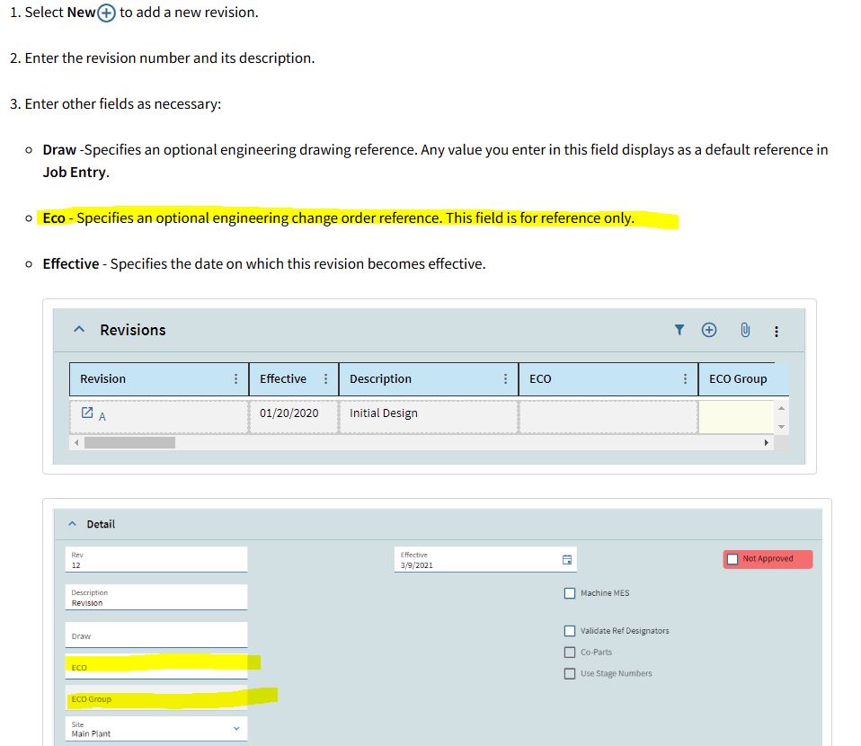

In Revision we have two ECO fields. ECO and ECO Group. I understand ECO Group is where we check parts out to. What is the ECO field for, and is it related in any way to the ECO Group?
I have always taken that field to be used for external ECO for when they get imported into Epicor.

Can you weigh in on that ECO field and how or if it relates to the ECO Group. I know I use ECO group during the DMT importing. We are considering using the ECO field to store change notices.
For example, we have a part Rev B. The customer issues a change notice that the method of manufacture must change to include or exclude some specific step. The customer does not issue a new drawing rev yet. For now we have to keep making Rev B, but we cant make it using the standard MOM, so we would create an alternate MOM and put the change notice number in the ECO field. Then we keep making that part until the customer changes their drawing. At that point we can up-rev our drawing rev to B/1 (or whatever), and create a new alternate MOM on rev B. The whole time we are still on the same part and revision. Only the alternate methods and ECOs would change. We also see the draw num field, and are debating if we should use this or the ECO field for CN#s. :thinking:
eco is he field that stores the eco value… the “eco group” is the unfortunate name for a group of parts that are all being changed at the same time, but it is also no necessary for those parts to all be part of the same ECO. This does allow you to do whatever you want with the ECO Group. Some people simply reuse the same ECO Group every day, while others make the ECO Group actually mean what it says, and if there is only one part affected by the ECO, then they create the group for that purpose, but if there are 100 parts all affected, then they check them all out at the same time in the same group.
