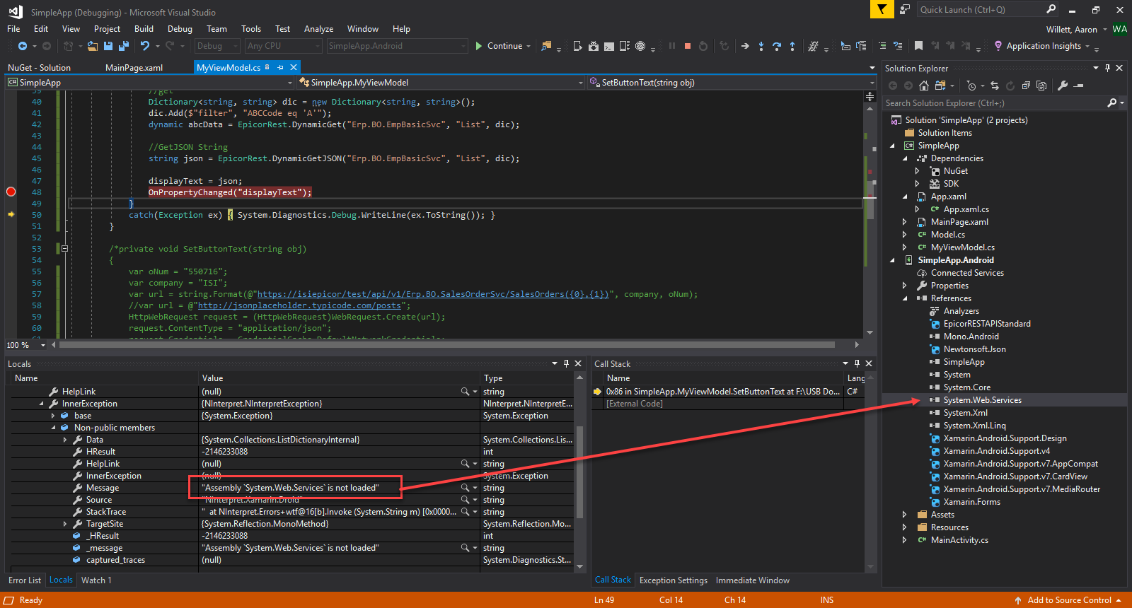

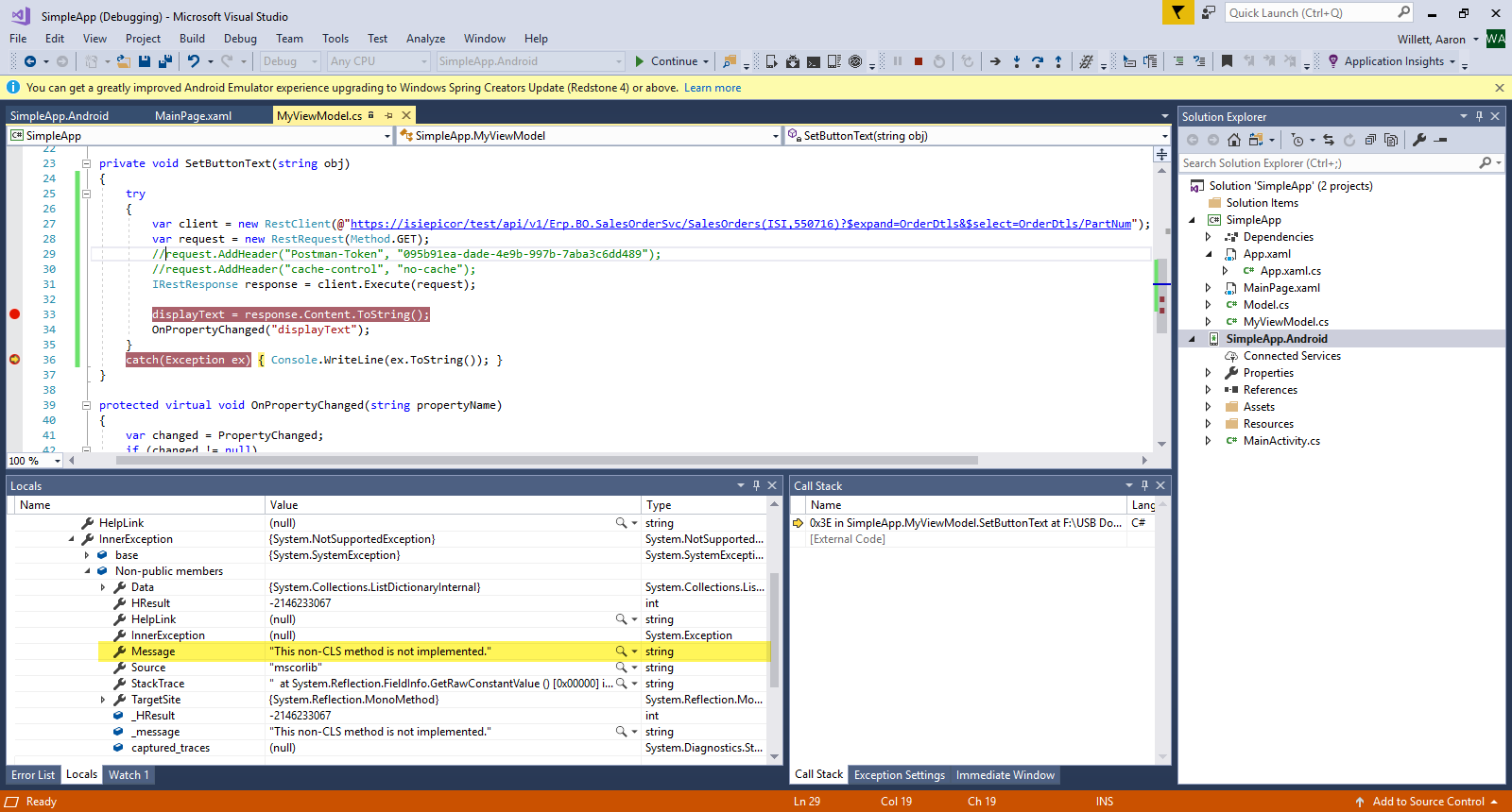

I’m trying to do a REST query and I’m getting the below error which Google is no help in identifying:

Any idea why I’d be getting that non-CLS error?

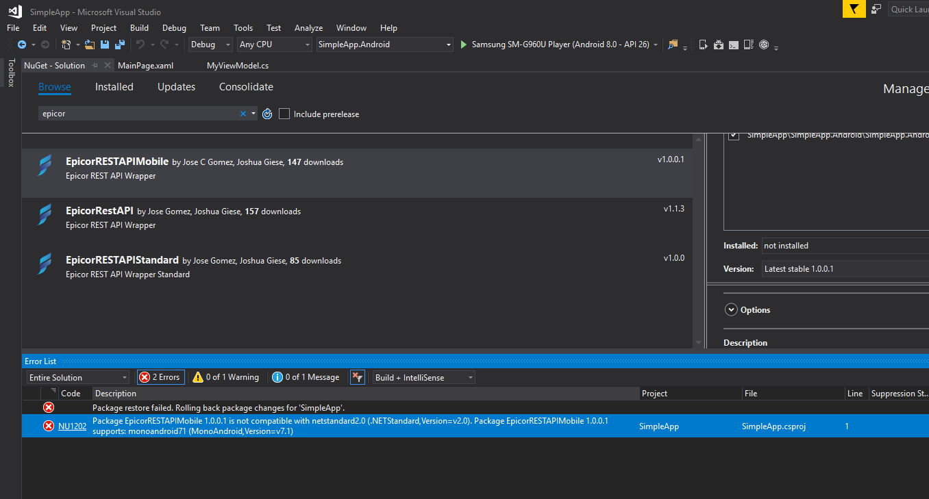

@jgiese.wci Do you guys have one for Oreo?

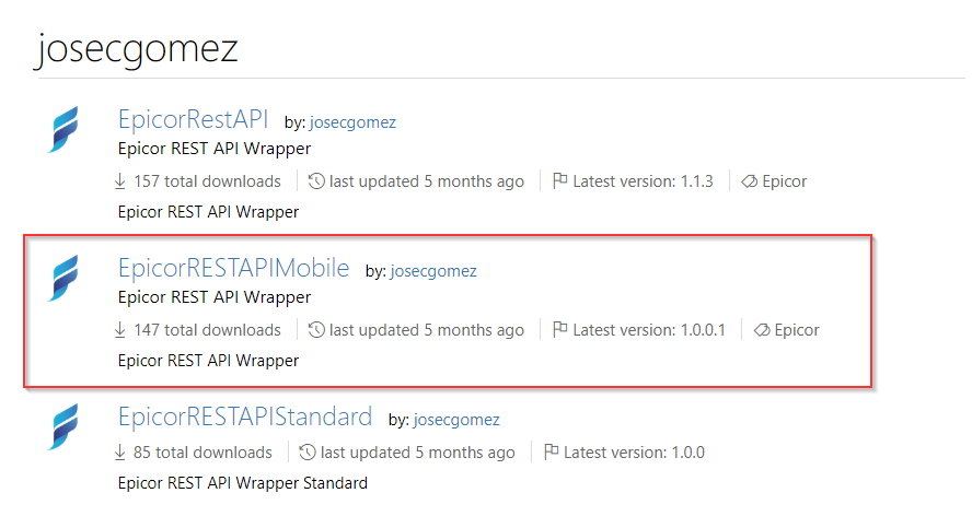

Grab the mobile one. It doesn’t care if it’s Oreo, Marshmallow or whatever is next. REST is generic. Works for IOS too
Try the standard instead.
That one worked.
yeah Standard is what you should use for Xamarin

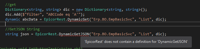

You got version 1.1.4.1? of the nuget?
If not you’ll need to update to it (we just published it)
