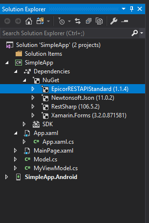

I don’t think it’s in the Android project, is it?
It was on the other screenshot you shared. Or maybe I’m seeing thigns…
Ah–I see. I have it installed in both.

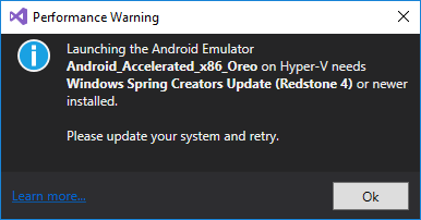

Looks like this may be an issue with the “Live Player” app I was using to run it instead of an emulator.
oh yeah, LivePlayer == the suck. use the emulator.
I can’t because I don’t have the latest Windows update and I’m restricted by our work network. :frowning:
Use a real phone? Do you have a real phone you can use? CC:better @Chris_Conn?
