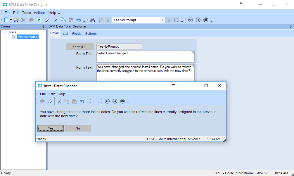

Thanks for the reply Nathan. I looked up the BPM data form and found stuff for E9 that used ABL Code. I was able to create the form…
But can’t get E10 to activate it. I used the Call BPM Data Form function and set it to my new form…
But it wouldn’t show the form, just bypassed completely and went to Show Message. I’ll keep looking for examples that are for E10, but any advice you could offer would be appreciated. Thanks for your time!

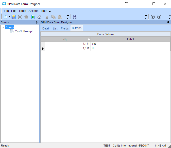

Shawn, can you screenshot what you got on the Field tab as well?
In the BPM Data Form Designer, under Actions > Test BPM Data Form you can test it out as well. I’d suggest you try that to see what comes up.
I run the test and everything works…
And there are no fields, only buttons…
The problem is that when I try to call it from a BPM, it doesn’t show at all. I’ve even created a simple BPM to just call the form and then give a message, but it doesn’t show…
