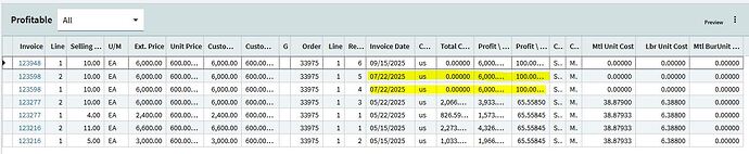

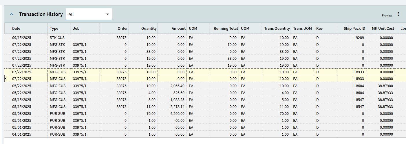

Finance has asked me to look into a profitability issue. For some parts it looks like we made 100% profit, because the costs are all $0. Reviewing the part transaction history, I can see this:
Here you can see on the 7/22 date a new shipment is created to the customer, and the unit costs are 0. This causes our profitability to get all messed up. We can’t figure out why the costs went to 0 here. I am no finance expert. Can you suggest where I should start looking?

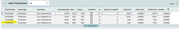

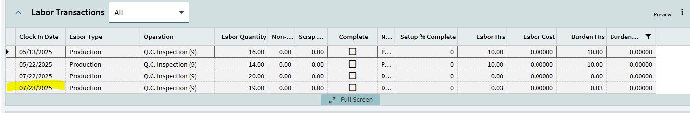

QC approved on 7/22 and then again on 7/23. This is the final op. Does this point to an issue?

I think we had this similar issue and IIRC we had to run the Capture COS/WIP process for Part tran to show the cost for MFG-CUS transactions.
We run it once a month, sometimes more often.
From our Profitability report. The costs should not have disappeared. :thinking:
so run it again and see if you see cost show up on Part tran.
You may want to look at how that Total Cost column is calculated and walk back through the transactions that make it up. The report could be using invalid assumptions, or the data could be bad.

Check the completion time on your QC operation reporting qty vs your shipment time from 7/22. I bet the qty was reported after the shipment. Since you had previously reported (30) on the job and shipped (30) I believe it didn’t have a qty to cost against.
