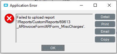

I wonder if I have to Sync Dataset on the Report Style. I did that and I had this error
Misc Charges
