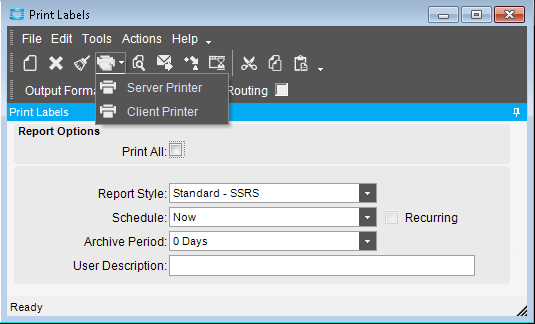

I have a customer that is looking to use the Standard functionality for printing labels but instead of using the SSRS option he would like to be able to create a bartender file.
Receipt Entry> Actions> Print Labels> Select bartender report style and generate file.
From what I have seen, I can create a bartender style (for RcvLabel) but when I go to the print option I only get the Client printers and I require a server printer, does anybody know if I could be missing something or if it is even possible? Thank you!

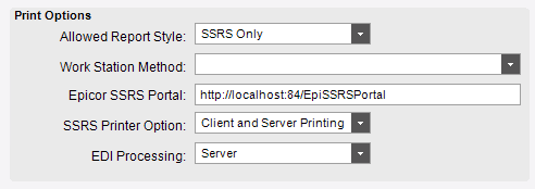

In Company Maintenance what do you have selected under Email and Reporting?

This depends on the setup I posted. Can you post your settings? If Client and Server processing are selected they will need to click and select server printing and then print.

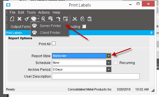

Hi Dan, here is my setup:
  • I created a Bartender report style
  • When I click Server printer, the Client printer screen appears
You might want to check this out. When using the Bartender report style this is really to be expected. This link might give you some other ideas.

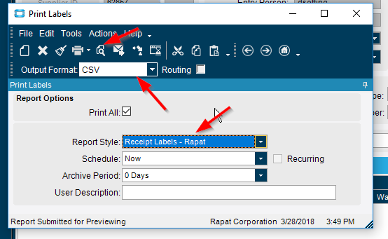

For our reciept labels, we created a CSV output, then made an excel macro in the personal workbook so once it opens in Excel hit can hit Ctrl+Shift+P and excel writes the file to a csv in the drop folder for bartender. It’s not ideal, but does a decent job of doing what we need it to.
Why not generate and drop the CSV right to your bartender pickup folder from a part tran bpm directive? There should be some examples of bartender printing from code in the forum here somewhere.
Here’s a write to CSV with a button.
