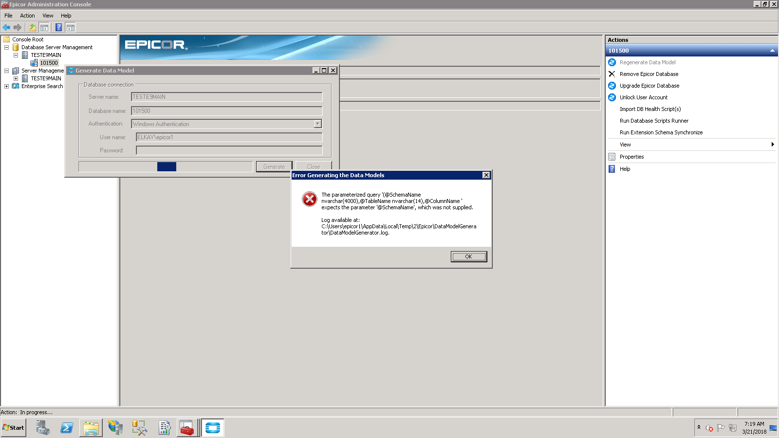

I’m working on upgrading our database on our sandbox server from 10.1.500 to 10.2.100 and received an error on the last step (3000 Data Model Regen). I tried manually regenerating it per the instructions, but I receive the same error. Has anyone seen this one?
Here’s the info from the log it references:

Error Generating the Data Models: The parameterized query '(@SchemaName nvarchar(4000),@TableName nvarchar(14),@ColumnName ’ expects the parameter ‘@SchemaName’, which was not supplied.

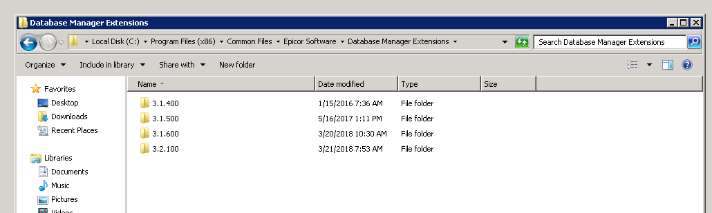

That smells like an old version plugin is being used, not the current one:
e.g. - The Data Model Generator has a plugin model. Based upon the version you are using, different code is executed:
I think we added that param some time ago so some I would have assumed there in 10.1.500 even. Something odd to review with a support call
I have a quite a few of those. Should I maybe try deleting/moving the old folders?
I’ll bring this up with support when someone is assigned the call.
They SHOULD be vectored to when you open the AC so SHOULDN’T be an issues. I am worried not finding why now will cause issues late (Unless somehow the wrong version dlls got copied into the wrong folder at some point.
If you don’t need to talk to those versions you don’t NEED them unless I am missing something in the minutiae. Support call is best bet as they may have a KB on something I don’t remember or they found after I was done in that area. That framework branch was Sept 2015 for me so getting a few cobwebs on it in my brain :wink:
