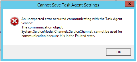

I have the most up-to-date Task Agent Service and I noticed the reports are not printing. Looks like the Task Agent is just continuously crashing.
The Bindings for the Instance and Agent are both UsernameWindowsChannel - I even reinstalled the Agent by uninstalling it, re-configuring it. I rebooted the Server.
Has anyone seen an error like this before:
