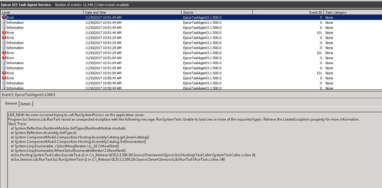

Yesterday, we had a problem with our app server and, in the end, I had to rebuild the site to get it to work.
All seemed good until this morning. The task agent seems to be in a constant error state.
Report generation actually works just fine, but when a BPM sends an email, it throws the below message into the ICE Task Agent event viewer.
The BPM is behaving just fine and I can see the proper messages showing up in the Ice.MailQueueBody table, but they aren’t getting sent out from there. Instead, it’s giving me that error.
I have tried stopping/starting the agent, restarting the agent service, reinstalling the task agent, and creating a new agent. I have also purged everything from the MailQueue table in hopes that it was hung up on one, but they keep getting queued up there.
Anyone have any idea how to sort this out?

So it was a big kerfuffle when it all happened…everything stopped working as the erpadmin password was changed (no one in IT can tell us why which is another issue ha ha). We got all the services back up after updating the password (In a million different spots it seemed) and everything was fine for a week or so. Then the emails stopped firing. We are now at the point where any email that is being sent through a BPM widget is good (after we changed it from Async, to Sync. Any that are set to Async go into Queue) But anything that is being sent through tasklists/workflow groups (specifically problematic anything coming from engineering workbench) is just ending up in the Ice.MailQueue table and not sending…
The other thing to note is that when we do a back up of live, and restore it to the test environment, ALL of the queued emails send as soon as test is up and running…
