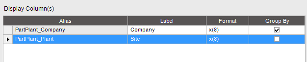

When I duplicate your BAQ, I get the expected error of
Severity: Error, Table: , Field: , RowID: , Text: Column ‘Erp.PartPlant.Plant’ is invalid in the select list because it is not contained in either an aggregate function or the GROUP BY clause.
For the SQL clause of
select
	[PartPlant].[Company] as [PartPlant_Company],
	[PartPlant].[Plant] as [PartPlant_Plant]
from Erp.PartPlant as PartPlant
group by [PartPlant].[Company]

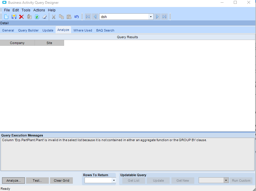

Ok, so in 10.2.300.6 when I click on Test I get the same error as @markb_wi, but when I click Analyze it does give me the actual error message. Do you not get the below error @markb_wi when clicking Analyze in your version?
Oh boy did they switch the order of the buttons? Here’s what I’m seeing in 10.2:
It looks like they didn’t re-order the buttons but the test button used to return the same information the analyze button did. Not a huge deal but I was pretty surprised. Thanks for the help!
In 10.1.400.23 …
  • Buttons are:
  • Analyze results:
    Column 'Erp.PartPlant.Plant' is invalid in the select list because it is not contained in either an aggregate function or the GROUP BY clause.
  • Test results:
    Severity: Error, Table: , Field: , RowID: , Text: Column 'Erp.PartPlant.Plant' is invalid in the select list because it is not contained in either an aggregate function or the GROUP BY clause.
    Query returned 0 row(s).
    Query has no more records to return.
    Query execution total time: 13.4291 ms.
Something changed in 10.2 I guess where you need to click Analyze to see the actual error now.
