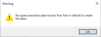

When I attempt to Get a BAQ Query Execution Plan I receive the following:
Can anyone advise.

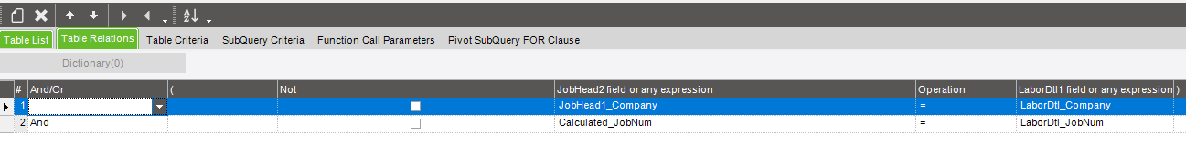

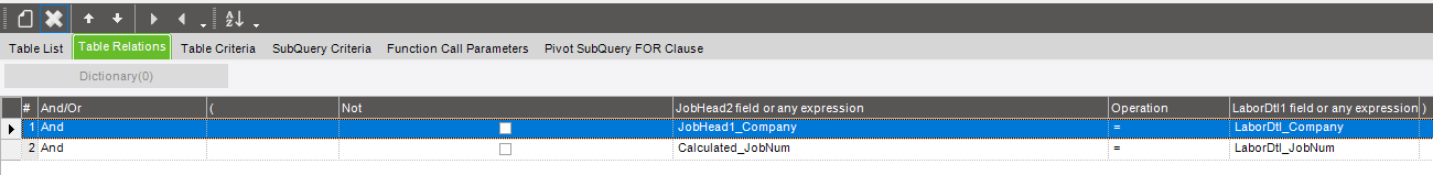

20/04/2020 - an And has been added (by the system) to Joins as the first Table Relation on all Joins
This is very strange behavior - has anyone seen this before?

The error in the first message means that you need to click Test button in the query designer first, and then look at the query execution plan.
If it still does not work, use SQL profiler to capture your query and then run it in SSMS to look at execution plan.

I’ve hit Analyze - then Test but still no Query Execution Plan.
I’ll try through the SQL Profiler.
Agreed with @Olga, you need to Test the BAQ once you get the data grid to load then you can export the SQL Execution Plan and open it up in SSMS to see the results.
hit Test, not Analyze
Hi Olga,
I have hit Test - still produces the same error.
Not sure what might be causing this?
