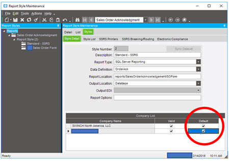

Hi @tfenwick11,
I think what you are looking for is in Report Style Maintenance. You can pull up the Report and Style that you want as the default and check the “Default” checkboxes for each company you want it applied to:
@ERPSysAdmin Awesome, just what I was looking for!
