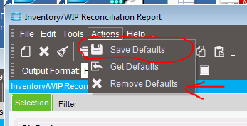

Make sure the user (or you) didn’t “set defaults”. Try using “Remove Defaults”
Using “Save Defaults” with a report style that isn’t the default, will override the default style.
