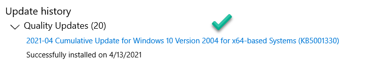

2021-04 Cumulative Update for 2004/20H2 (KB5001330)
Well, here we go. Let’s see if the latest cumulative update still causes the performance hit or if it has the “fix” baked in.
Unfortunately yesterday I tried installing 2021-03 on my laptop and then applying the fix from MS/Epicor, as provided toward the end of this thread (Sudden drop Epicor speed caused by Microsoft Updates -> (KB4601319, KB5000802, KB5000808,KB4601382,KB4601383) + - #239 by aidacra) and it didn’t seem to be solving the performance hit for me. Job Entry still spinning and taking 6-10 seconds to load a job instead of 3-6 seconds, even after appying the local group policy and a reboot.
I installed the 2021-04 on my pc this morning and on one of the sales teams pc and noticed a great improvement in speed
I’ve installed it on my personal PC and my laptop, and in both cases it seems to have caused the return of the performance slowdown - 6-10 seconds to load/switch jobs in Job Entry. The good news is that it seems that applying the fix from Microsoft seems to be working effectively to resolve the performance hit now with 2021-04 (KB5001330) installed, on these two machines at least. Seemed to not work as well on 2021-03 cumulative update for whatever reason, but maybe I just needed two or three reboots for good measure. :man_shrugging:

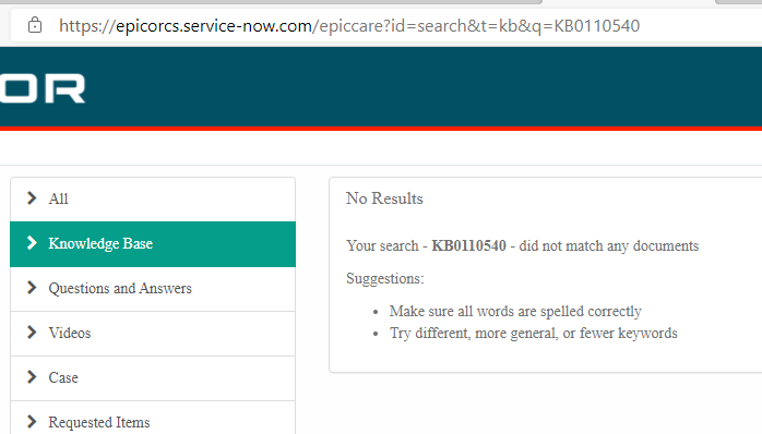

What is this ‘fix’ you are talking about? I can’t get to the Epiccare article even though I have a login. It says no article found.
I want to see if it helps us. I am having the slowness issue as well as some of our users. I do have the 2021-04 installed
thanks
https://epicorcs.service-now.com/epiccare?id=epiccare_kb_article&sys_id=abdb5c9bdb972410a587ef0705961996
If that doesn’t work, maybe you can just login to EpicCare and search for the article?
Should show up under KB0110540
https://epicorcs.service-now.com/epiccare?id=search&t=kb&q=KB0110540
Can’t get to it - not sure why this is so difficult for me
If you haven’t accessed it yet, make sure you’re logged in before trying to access the link. It really should let you know that you can’t access it because you aren’t logged in.
I sent you a private message @jimship
