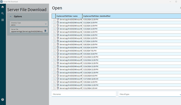

Where should I look for details when my BAQ has an error log?

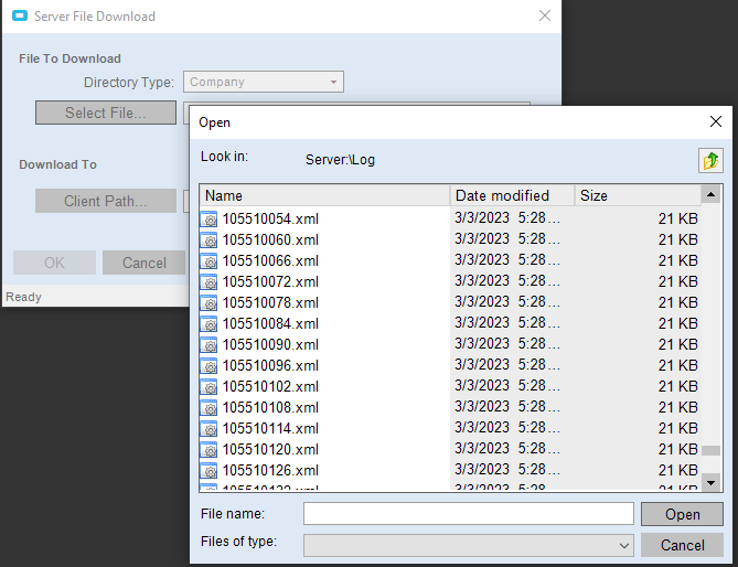

from Epicor navigate to System Management > Schedule Process > Server File Download: On the Directory Type, select Company and click Select File, this will take you to the server where log files are stored. Select the Log folder and you should be able to find the Log there:
Thanks, your reply was very helpful and I think I found it
