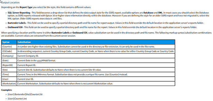

Have you tried Server File Download?
From help.
I found what I was looking for under a System Maintenance/Scheduled Process/Server File Download
