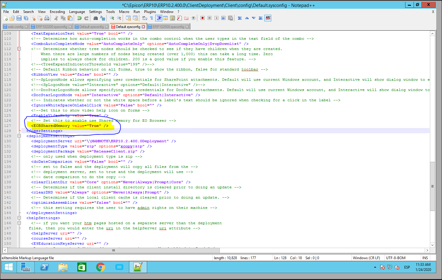

Here is what they proposed:
Good day, I get an answer form developer team, you need add a line in one file on your workstation: * Make a right click on your epicor icon and
go to properties. * On the shortcut tab review on the target field which .sysconfig file , you are using * On that window make a click on the button “Open File Location” * Now open the folder “config” * Search the sysconfig file that you are using, and now
please select it and then press ctrl +C and then crtl+ V (this for made a backup for the file) * Now the oroginal sysconfig file open it and search the section and add this line After make the change, please
save the file and try access to Epicor *** Note: I will attach a screenshot for this If you have any further question, please do not hesitate to let me know. Regards
