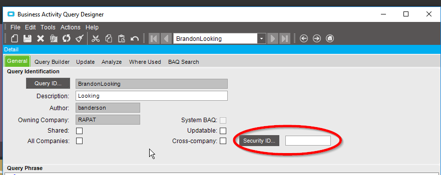

While they may be able to add them, when they try to view them, do they get information in the grid? Some tables have security where the BAQ will be visible, but it won’t return any rows.
But like @josecgomez said, I would set the security on the BAQ level as well, because not everything has this security.
Reminder - Hiding things in the UI is not security - that’s ease of use.
If you care about data, you need to secure it. Learn the data and method security areas. It’s easy to use rest to url at data and 2 lines of code to access via integration approaches going back to V8.

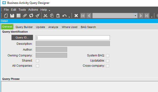

Sorry to bring up this old post. We’re in the process of adding security to all our BAQs to prevent any user to see sensible data in their active homepage (which is not an easy tasks since we have tons of BAQs to go through).
Seems that Epicor’s built-in BAQs have the Security ID field greyed out. How can someone set security on those?
