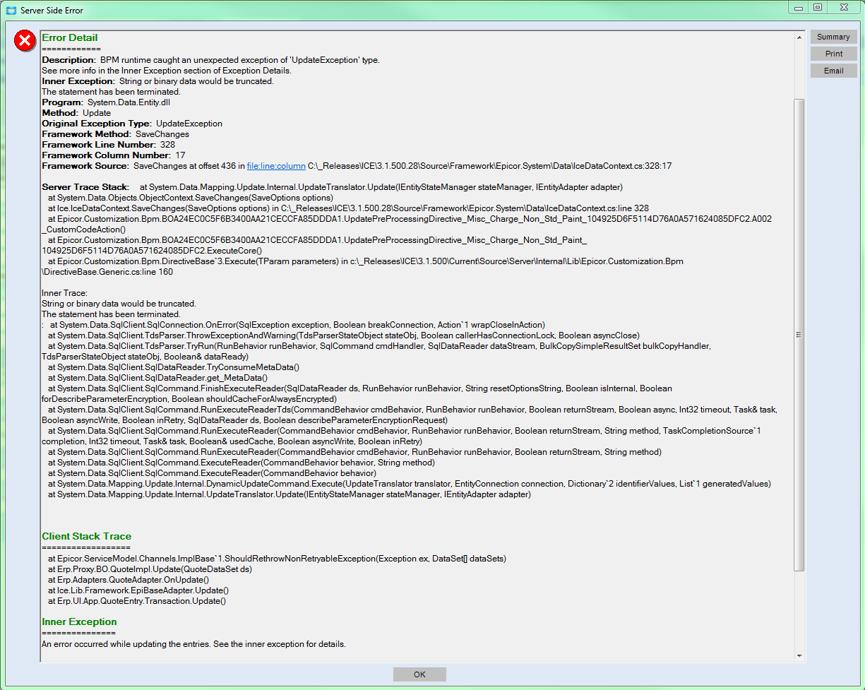

You are checking to see if the QuoteMsc exists… (it won’t) I think your If statement needs to be
if (QuoteMsc_xRow == null)
Thanks @josecgomez, I tried that and got this error’ I should have mentioned that it is a pre processing method directive on the Quote update
