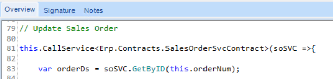

But in Functions it seems we need to use CallService and we end up with code looking like this:
I am still a little fuzzy on why that is the case, but anyways, how would we bypass facade when calling BOs from Functions?
I believe you will have to make your own context.
Oh wait, it bypasses data directives too? Hmm, I still want my change logs…
