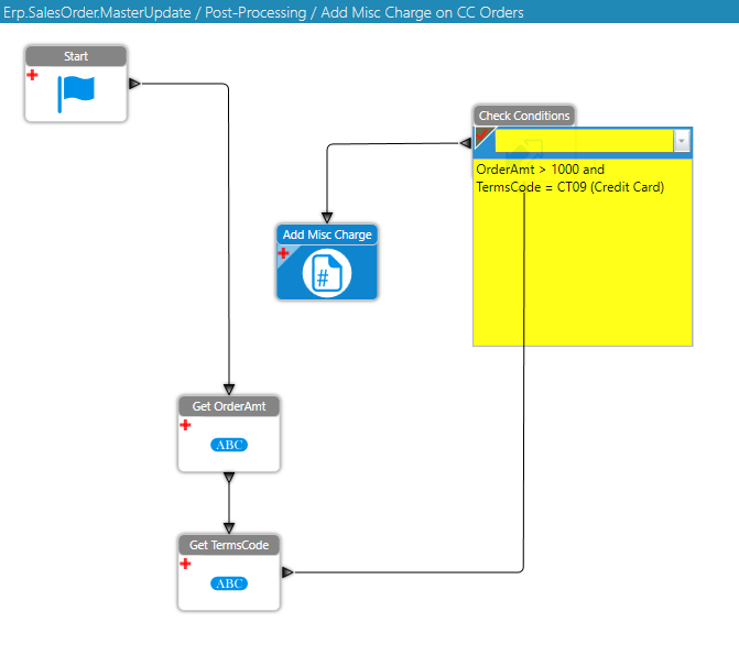

Yes, for Orders I moved it to Post-Processing. I used an in-trans data directive for the Quotes (not sure if you’re there yet or already past it but don’t forget about quotes! The Order does not update like you’d want it to when you convert a quote to an order - so you need to have it right on the quote before you convert it to an order).
We added the miscellaneous charge specifically for credit card orders > $1000. To make sure it was a credit card order, we checked the Payment Terms.
If I remember correctly, I had to write a LINQ statement to retrieve the order amount and terms code from the database because it was not populated in the temp-table dataset that you get at post-processing. Pics below for reference.

Add Misc Charge
