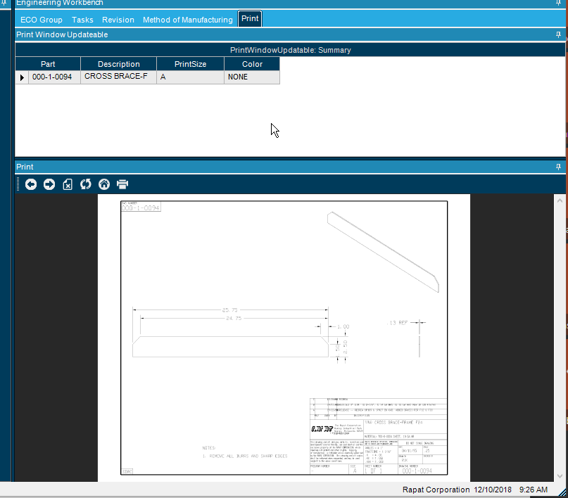

I have a dashboard that is embedded in my engineering workbench for showing prints. It works great. I also display some UD fields for reference like print size and finish. These reside on the part master, but I would like to be able to change them while working in engineering workbench.
Unfortunately, it looks like me and others have run into a snag that the publish/subscribe functionality will not work with an dashboard assembly.

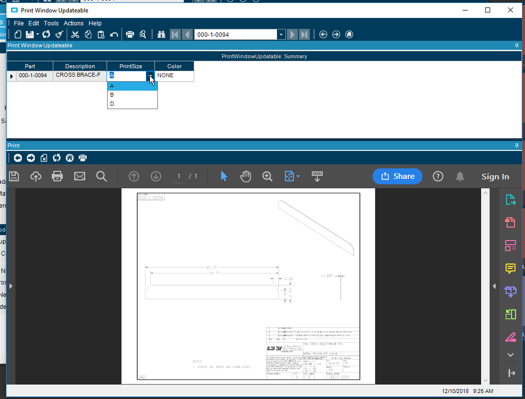

My dashboard works fine as a standalone. I have a process caller to do an open with and this works fine.
However when I embed that dashboard into my customization, the updateable fields are not updateable.

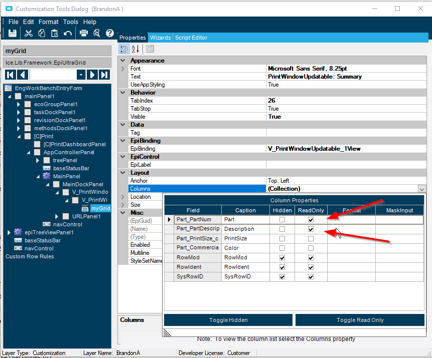

Those check boxes will not stay unchecked, and I’m pretty sure that’s because the fields are databound. But the extended properties are not set to read only, and I the fields don’t show up in the extended property wizard in the customization (probably because I don’t have a an FKV set up??)
Is there a relatively easy way to make the changes in the grid like a normal dashboard? Or do I have to do something like add an FKV and make the changes through custom controls somewhere else on the form?
I figured it out. I think it was because I didn’t add the controls in the setup of the dashboard. That would make sense, if I can’t save the changes, it would assume they aren’t changeable.

Dang it!!! yeah, you are right. The first time I open up the dashboard, it’s on the right part, which is why I thought it was working. But if I have two parts checked out and I switch to the next part, the dashboard doesn’t follow along. It’s stuck on the first part.
Annoying…
I wanted to clarify something. While I thought the check boxes for the controls had something to do with the updateable nature of the dashboard, it does not. I just did something else wrong with the saving of the customization. Even if leave those unchecked, it’s now updateable.
But I still have the problem that if I make a change using the dashboard, it will no longer update as I change parts. It will follow along fine until I do that, but it’s kind of useless if I have to keep reloading engineering workbench just to see the correct information.
or " … not updateable." ?
nope. Those checkboxes had nothing to do with whether the dashboard came through as a working updateable panel or not. I thought they might have, because initially they were not updateable, and I re-added the dashboard with those check boxes checked and they changed to updateable, so I thought that’s what caused the change, but later in my dinking around, I re-added the dashboard with both of them unchecked, and it was still updateable. Which is the opposite of what I had stated earlier. So that temporary correlation did was not the causation that I had assumed.
I have been told by Epicor support several times that you can not embed an updateable dashboard and I have never been able to get one to work.
