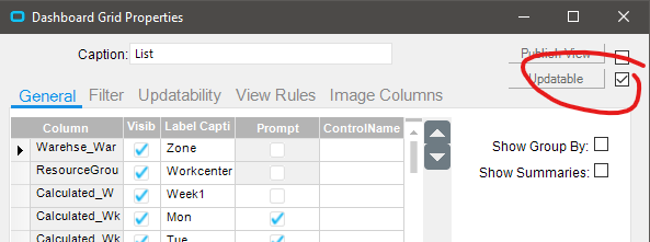

I have the BAQ set up where it is running and executing the updateable field. I am trying to make that into a Dashboard for people to use, I have Deployed it but am not able to Update the field I wanted to do. As I said it works fine in the BAQ. The field is a UD field that I have added to the Plant table, but can’t get it to update on the Dashboard after deployment. I have now just tried the testing before full deployment and still an issue. What am I missing with this. Is there someone, I can work on this with?
In the grid properties, did you select updatable:
In Menu Maintenance, did you add it as Dashboard-Runtime or Dashboard-Assembly? To be updateable, it needs to be Dashboard-Assembly.
This is the part I forgot to do. Thank you. It works now.
