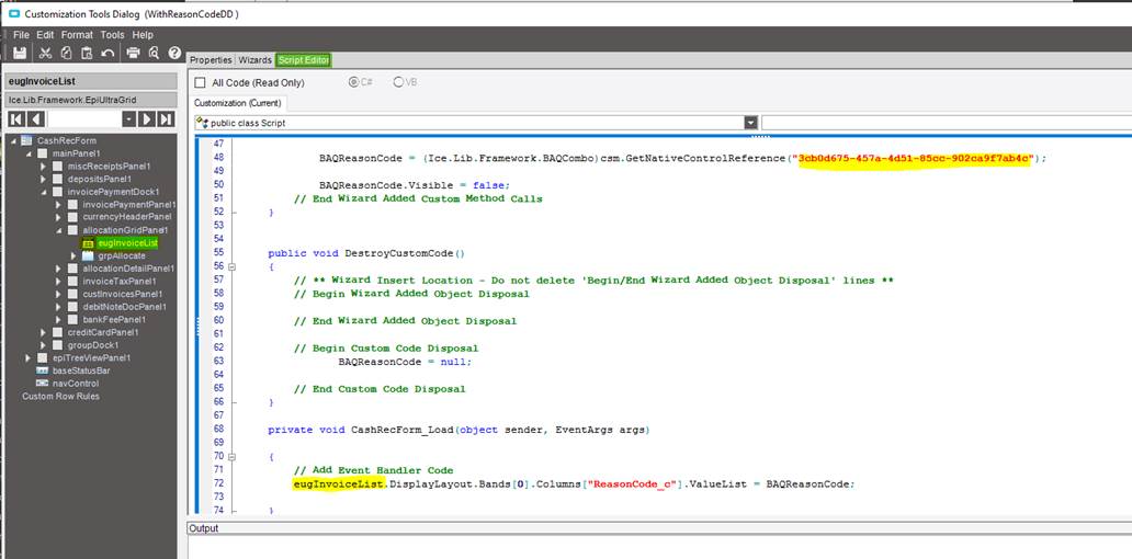

Is there a way I can attach a dropdown list of valid entries for this UD field in the grid?
Yes, it can be added.
Thank you – can you please point me in the right direction on how I can add this as a dropdown in the grid? I set up a user code and added it to the extended properties on the UD field but Epicor support tells me that can not be used for a column in a grid.
Please find below example. In this, I have defined a BAQ Combo which is linked to job listing and added in the grid and made invsible. On form load event, get the grid value and add to the required field. In this case, I have added to a Job Number.

Ice.Lib.Framework.BAQCombo BAQComJobNum;
BAQComJobNum = (Ice.Lib.Framework.BAQCombo)csm.GetNativeControlReference("3cb0d675-457a-4d51-85cc-902ca9f7ab4c");
BAQComJobNum.Visible = false;
// Begin Custom Code Disposal
BAQComJobNum = null;
// End Custom Code Disposal
private void TimeExpenseForm_Load(object sender, EventArgs args)
// Add Event Handler Code
EUGTEEntry.DisplayLayout.Bands[0].Columns["JobNum"].ValueList = BAQCJobNum;

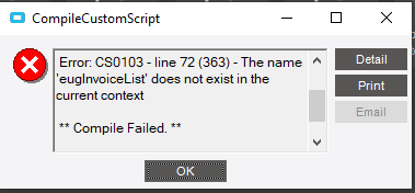

private Ice.Lib.Framework.EpiUltraGrid csGrid;
csGrid = (Ice.Lib.Framework.EpiUltraGrid)csm.GetNativeControlReference("ba70e2ef-161a-4aa3-933d-220d53a21528");
csGrid.DisplayLayout.Bands[0].Columns["SalesUM"].ValueList = cmbSalesUM1;
Got it!!!
