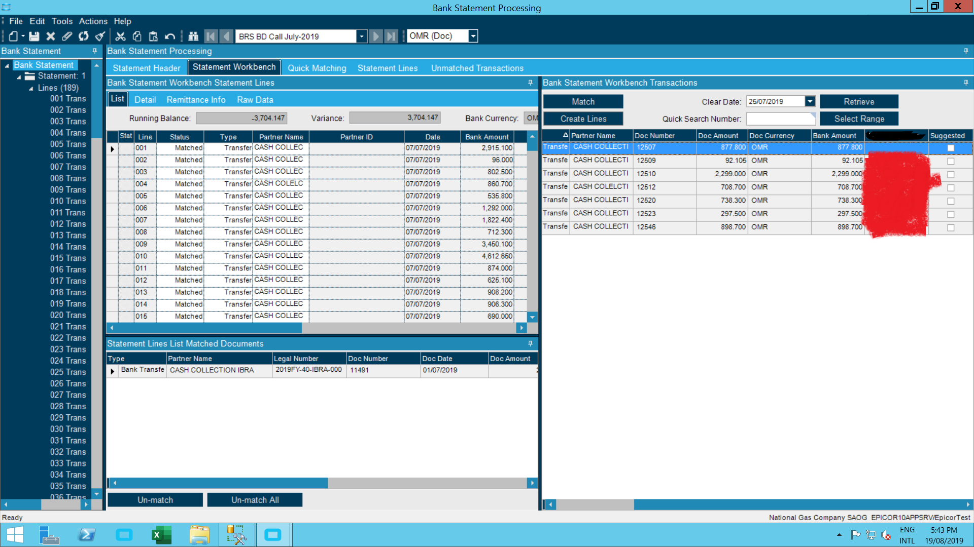

Dear experts, Please let me know how to add FKV columns in list (grid) view (i.e. without needing to write C# code) and which aren’t hidden in the collection.
For Example : In Bank Statement Processing how we have to add Bank Transfer “Tran Reference” column value in grid list which is not exist in the collection refer to below screen
This restriction makes this request Impossible.
Please let me know, how it is possible then.

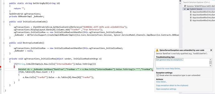

We have added the below mentioned code in script editor
EpiUltraGrid ugTransactions;
private BOReaderImpl _boReader;
	ugTransactions = (EpiUltraGrid)csm.GetNativeControlReference("8100810c-d3ff-4d7b-acde-a12e8d4335ea");
	ugTransactions.DisplayLayout.Bands[0].Columns.Add("TranReference" ,"Tran Reference");
	ugTransactions.InitializeRow += new InitializeRowEventHandler(this.ugTransactions_InitializeRow);
	//_boReader = new BOReaderImpl (((Session)oTrans.Session).ConnectionPool);
	_boReader = WCFServiceSupport.CreateImpl<BOReaderImpl>((Ice.Core.Session)oTrans.Session, Epicor.ServiceModel.Channels.ImplBase<Ice.Contracts.BOReaderSvcContract>.UriPath);
	ugTransactions.InitializeRow -= new InitializeRowEventHandler(this.ugTransactions_InitializeRow);
	_boReader = null;
private void ugTransactions_InitializeRow(object sender, InitializeRowEventArgs e)
	if(!String.IsNullOrEmpty(e.Row.Cells["InternalNumber"].Value.ToString()))
		DataSet ds = _boReader.GetRows("Ice.BO.BankTran","TranNum ='" + e.Row.Cells["InternalNumber"].Value.ToString()+ "'","TranReference");
		if(ds.Tables[0].Rows.Count > 0 )
			e.Row.Cells["TranRef"].Value = ds.Tables[0].Rows[0]["TranRef"];

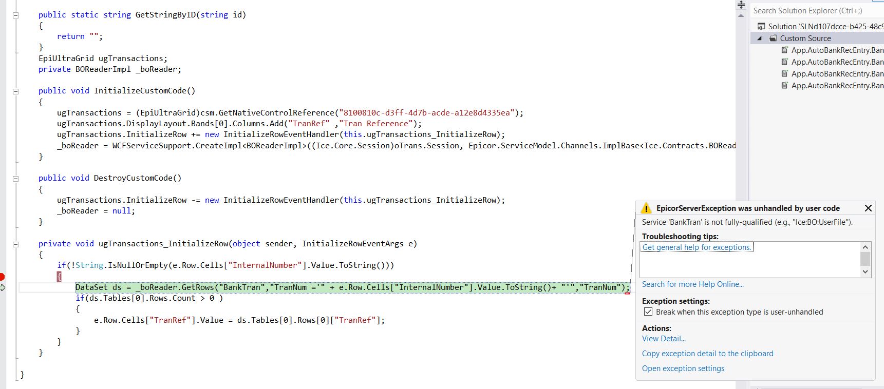

but system is throwing error
Anyone can suggest how to get TranRef column value from Erp.BankTran table using BOReeader
_boReader.GetRows(“Erp:BO:BankFundTranEntry”,“TranNum = '” + e.Row.Cells[“InternalNumber”].Value.ToString() + “’”, “TranRef”);
