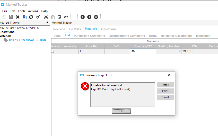

I see two problems:
1- As you can see in the code, the Company2222 is added to the columns which I used for my reference, however Part Type did not get added.
2- Company2222 does not load any data and when I click on it (notice the difference in color of its column) and type something, I get this:
Please notice that I am not trying to enter any data so I am confused why this field is fallible now as well.
Many thanks in advance
Regards,
Shizar
I made a few mistakes.
Apologies if that caused confusion. I figured these:
1-
myGrid.DisplayLayout.Bands[0].Columns.Add("Part Type","Company222");
should be changed to:
myGrid.DisplayLayout.Bands[0].Columns.Add("TypeCode","Part Type");
2-
DataSet ds = _boReader.GetRows("Erp:BO:PartEntry","PartNum = '" + e.Row.Cells["PartNum"].Value.ToString() + "'","RevisionNum");
Should be changed to:
DataSet ds = _boReader.GetRows("Erp:BO:Part","PartNum = '" + e.Row.Cells["PartNum"].Value.ToString() + "'","RevisionNum");
After these changes, I still get the white-background column. The error this time has changed to this:
Which does not make much sense. TypeCode is indeed a column in Part table…
