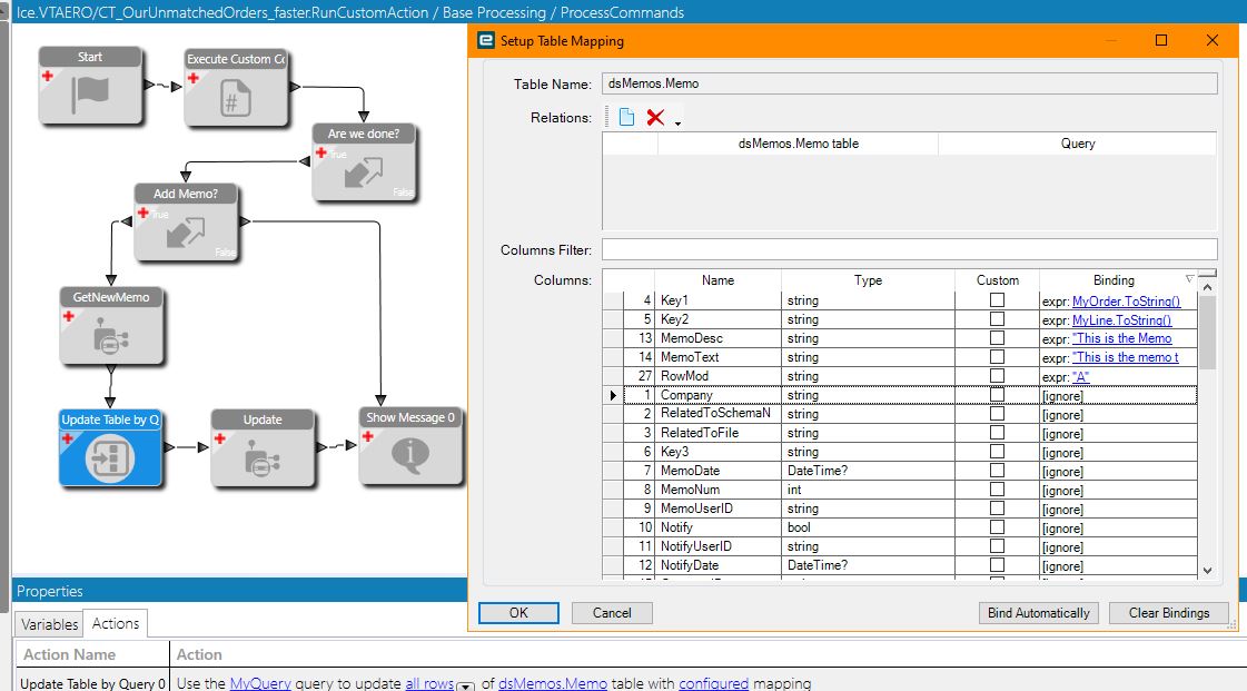

I used a boolean called CloseOrder set to true if the program decides to close an order. After this custom code executes, I use a Memo.GetNewMemo widget, along with an Update Table by Query and Memo.Update widgets to try to create the details for the new memo. This actually works ok. My only problem is that I don’t know how to get the RelatedToSysRowID field for GetNewMemo. I think this is how it links to the Order number. I have to set this filed when I GetNewMemo. How can I point to the correct Order Number? I used a trace and set key1 to OrderNum and key2 to LineNum, but I can’t figure out how to get that GUID.
I appreciate any ideas. Thanks!
