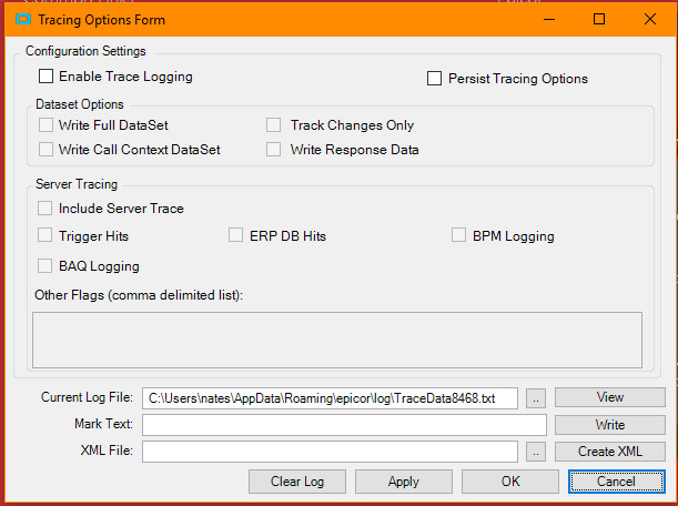

This looks really helpful. I tried to add your bit of code to the top of my first custom code element. But it doesn’t like the syntax.
Can you help me design my trace syntax?
Epicor.Hosting.Trace.ServerLog.WriteTraceMessage(
“trace://ice/mytrace”,
“TraceCategoryLabel”,
() => “Some Text”
Once I have the syntax, I access it through my usual tracelog, right? Can you tell me which options to turn on?

Now remember this is a Server Side Trace (cause it runs on a BPM)
So follow the instructions on the other post to Enable it.

You cannot change the appserver.config.
As far as tracing goes, you might be able to get the tracing from the Server File Download program. Select the Company folder and browse the files under your username or the manager. You might find your traces there. I got fiscal year-end going on now otherwise I would be able to check it out for you.
