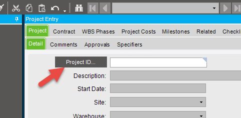

@Chris_Conn is there a way to set the Advanced Search as default instead of the Base one when clicking the Project button?
or does the user need to select it from the Advanced tab?
I know you can set a Quick Search as the base (or as the base for this specific form\context), not so sure about Advanced Search though. At a minimum, you should be able to place your own button over that one and use code to call the Advanced Search.
Yeap I believe the button option would work.
