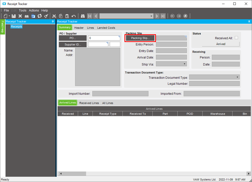

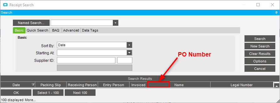

I have never customized a search, so I don’t know if it can be done or where to start. Looking at the Receipt Tracker screen and clicking the Packing slip Search button. I would like to see the PO number listed in the Search Results. Any information would be appreciated.
Create a BAQ with all of the info you need, then create a Quick Search off of that BAQ.
Got it. Thanks
