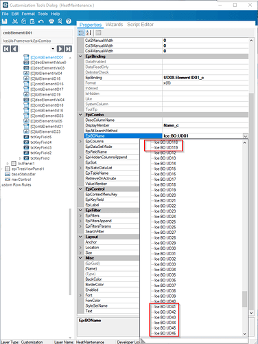

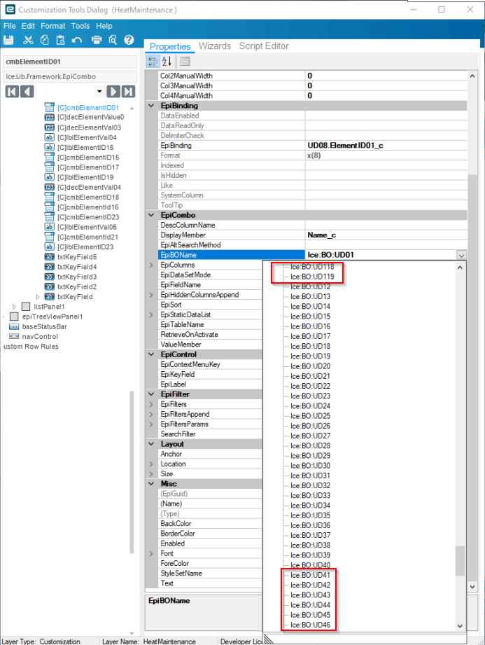

In 2022.2.8, I’m connecting an epiComboBox to the UD01 BO when I see this:
It shows UD01-UD98 and UD100-UD119. I don’t remember this being here. And I don’t see any reference beyond UD40/UD110 anywhere else.
Is an extension of UD tables a coming feature?
Joe

Sorry folks - extra UD table references are an error. There are no plans to add any new UD Tables, UD Table Services, or UD Table UIs to Kinetic.
That said, stay tuned for upcoming feature that makes extra Epicor UD tables / services / UIs unnecessary…
