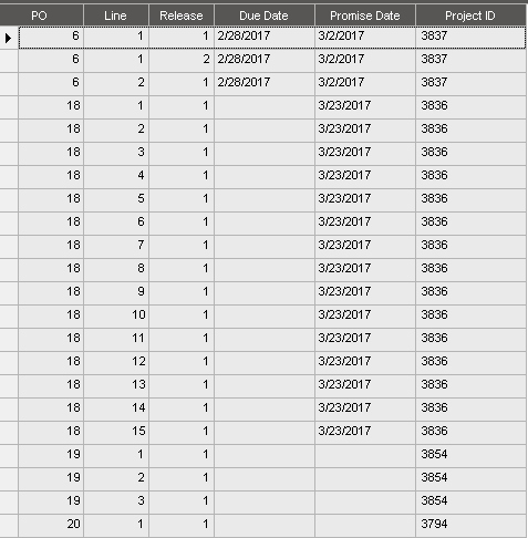

I figured out what the issue was. One of my columns was due date and the PO’s attached to the project I was testing didn’t have due dates. Can I make it so it shows the BAQ results even if a field is empty?
Testing with 3836 didn’t work but 3837 did.
thats the BAQ from the designer btw
I mean the grid doesn’t care if the field is empty or not… if you want the PO to show even if there is no DUeDate just make sure that’s not a requirement within the BAQ
retested with 3836 and it worked sooo I’m just not going to question it as long as it keeps working.
