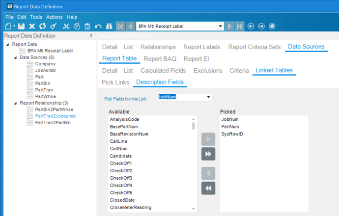

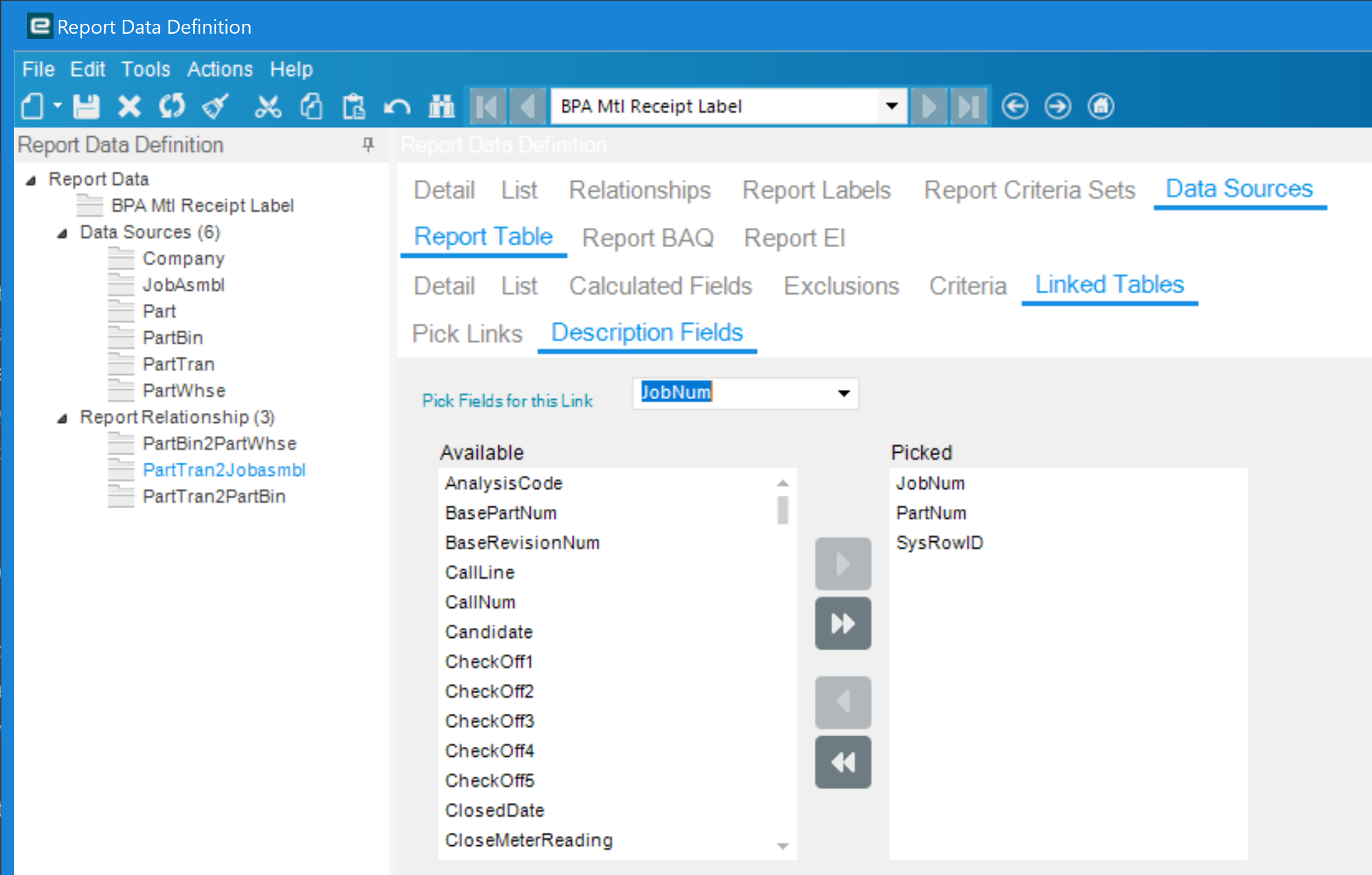

I am trying to add the JobAsmbl table to the GenInv report in order to add a couple of UD fields from the JobAsmbl_UD table so they will autoprint on a label using Bartender.

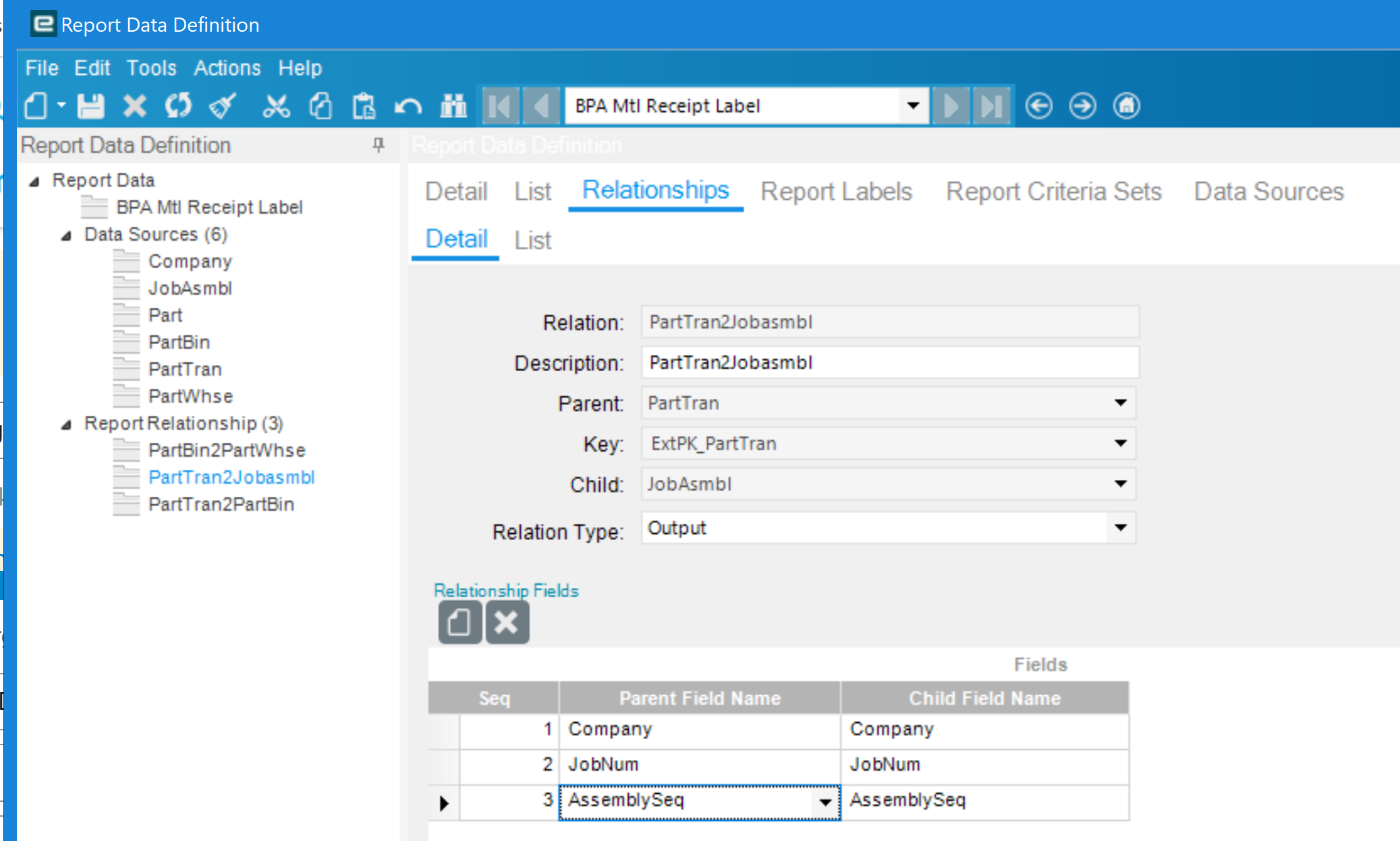

I have added JobAsmbl, but I am getting only empty fields on the JobAsmbl table when a label file is printing. I know the use of UD fields in GenInv can be problematic, but for now merely adding JobAsmbl is an issue.
I have tried a number of suggestions from other posts like flipping the Relation Type from “Definition Only” to “Output”, and I have tried adding UD_SysRevID. I only show UD_SysRevID on the JobAsmbl Child table. The PartTran parent does not have this in the list. On all of my tables I have made sure that I do not Exclude any field that could even be remotely required.
Below is my current setup. It is giving me results for all tables except for JobAsmbl…
