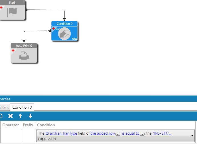

I am having the hardest time with a simple data directive to auto print a Bartender label triggered by TranType INS-STK on an added row to the PartTran table.
The data directive I have in place generates a GenericInventory file as expected to our FTP, HOWEVER, the only table returning any data in that file is the Company table. Because I’m only using duplicates of the out of the box report style and data definition I assume the issue rests in the data directive set up.
Super vanilla widget set up

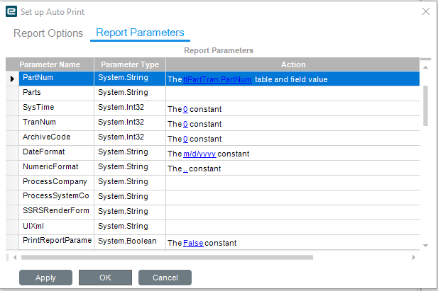

Report Parameters - mapping TranNum to ttPartTran.TranNum didn’t help
Can’t seem to figure it out and now I’ve been staring at it too long. Any ideas are truly appreciated.
