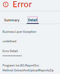

I am making a custom report style for ApCheck (Payment Remittance Advice) and am trying to add our Company Logo as I do with most forms, however it will not upload the zip if I make it Database, only if I do one embedded.

No we have various images uploaded in Epicor and we select them from the Report Style ā€œImage Listā€ but I cannot do this for this report because as soon as I try to ā€œinsert imageā€ as ā€œDatabaseā€ into the SSRS header then save and zip, it will not upload to the Report Style with the error I pasted above.
However, if I change to an ā€œembeddedā€ image and select one from disk, it works fine (but that is not what I want).

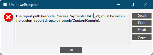

I think @Hally is right, here is the error I get in Classic UI

This seems irrelevant and more in the way you are uploading as this is referencing the ChkPrint report which is the other one in this report style.

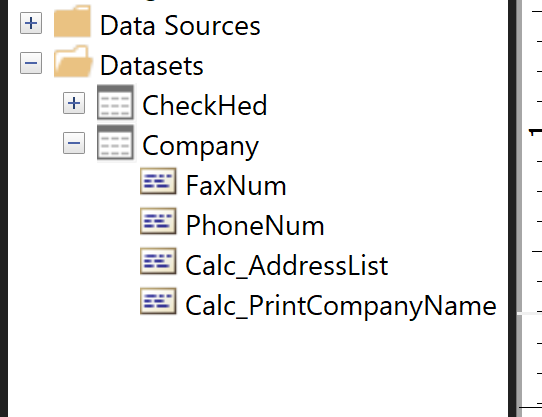

You havent added the dataset required for this to run. Therefore it is failing because you are referencing a dataset that doesnt exist.
What the??? All this time…Thanks, I’ll have to revisit. I previously had been messing with report images, but somehow never been able to get that to work… and sometimes life’s too short to undo past indiscretions… I think in some of the reports I had been working on the ReportImages dataset was not there.
So yeah the dataset is not there in 99% of the reports. However if you add it yourself mimicking one that does have it then it will work.

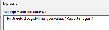

ā€œā€¦An error has occurred during report processing. —> Microsoft.ReportingServices.ReportProcessing.ReportProcessingException: Query execution failed for dataset ā€˜ReportImages’. —> System.InvalidOperationException: ExecuteReader: CommandText property has not been initializedā€¦ā€
Fixed, I compared with a working report and found the missing expression (which your pdf shows).
