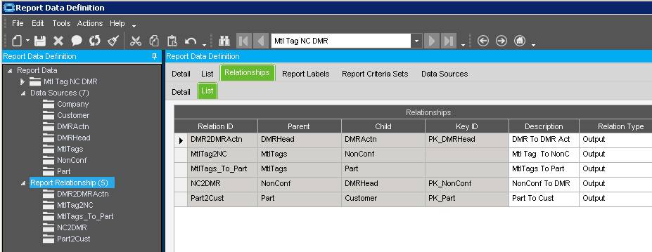

Adam,
Here is a snapshot of the RDD.
MtlTag to NC, NC to DMR, DMR to DMR Action.
The part tables shown are for other unrelated things.
FYI
Brad
