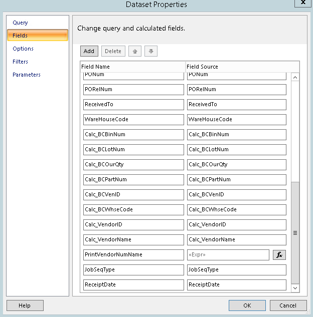

I would like to add the Receipt Date to our RcvLabel that I have edited to fit our label printer. The issue is that ReceiptDate does not appear in Report Builder for the RcvLabel.rdl. I have attempted to add ReceiptDate as a field in the Dataset properties. This did does not give an error when testing but it is only a blank field on the report (Im assuming because it is not actually linked to a field in the query). I also attempted to add it to the actual query in the dataset properties. My query was:
="SELECT T1.AssemblySeq,T1.BinNum,T1.IUM,T1.JobNum,T1.JobSeq,T1.LotNum,T1.OurQty,T1.PartDescription,T1.PartNum,T1.POLine,T1.PONum,T1.PORelNum,T1.ReceivedTo,T1.RevisionNum,T1.WareHouseCode,T1.Calc_BCAsmSeq,T1.Calc_BCBinNum,T1.Calc_BCJobNum,T1.Calc_BCJobSeq,T1.Calc_BCLotNum,T1.Calc_BCOurQty,T1.Calc_BCPartNum,T1.Calc_BCVenID,T1.Calc_BCWhseCode,T1.Calc_VendorID,T1.Calc_VendorName,T1.JobSeqType,T1.ReceiptDate
FROM RcvDtl_" + Parameters!TableGuid.Value + " T1"
(I added T1.ReceiptDate to the end of the query)
This gives an error in System Monitor.
Program Ice.Services.Lib.RunTask raised an unexpected exception with the following message: RunTask: System.Web.Services.Protocols.SoapException: An error has occurred during report processing. —> Microsoft.ReportingServices.ReportProcessing.ProcessingAbortedException: An error has occurred during report processing. —> Microsoft.ReportingServices.ReportProcessing.ReportProcessingException: Query execution failed for dataset ‘RcvDtl’. —> System.Data.SqlClient.SqlException: Invalid column name ‘ReceiptDate’.
Does anyone know how I can add this field to this report correctly? I am sure that ReceiptDate is in the RcvDtl table so I am unsure of why this error is occurring.
