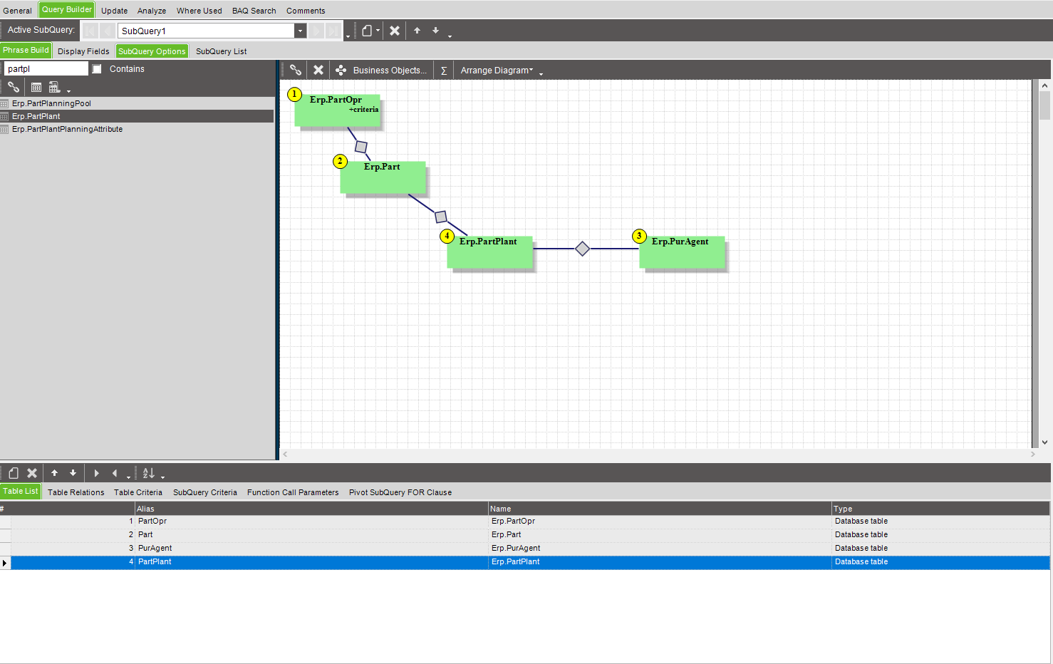

I did run into an issue. I have duplicate Parts. I am not sure how to get rid of them.

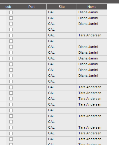

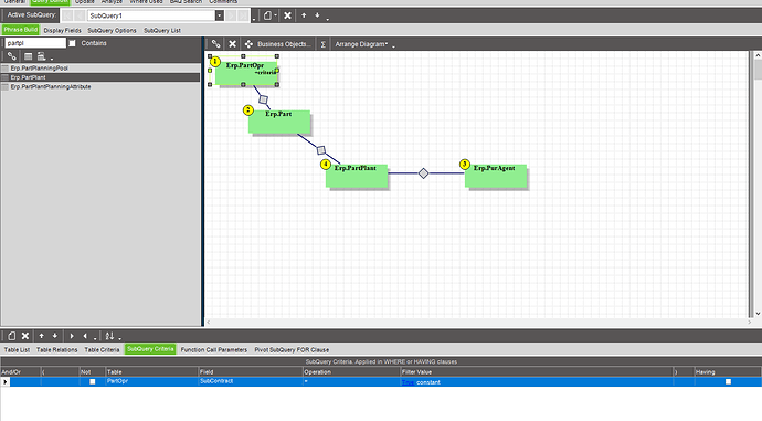

I am not sure I did it correctly. Still returning duplicate Part lines.:

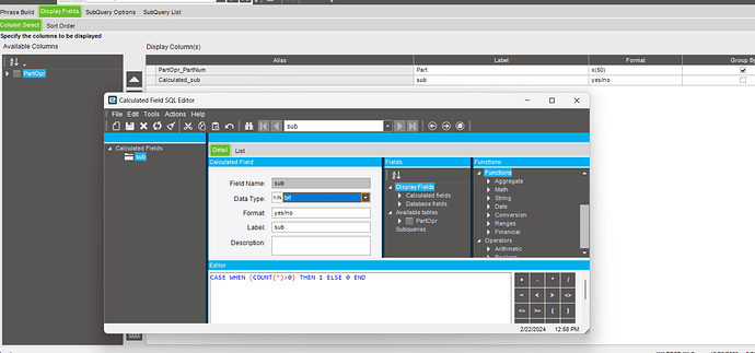

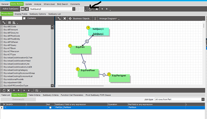

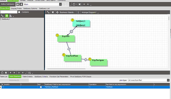

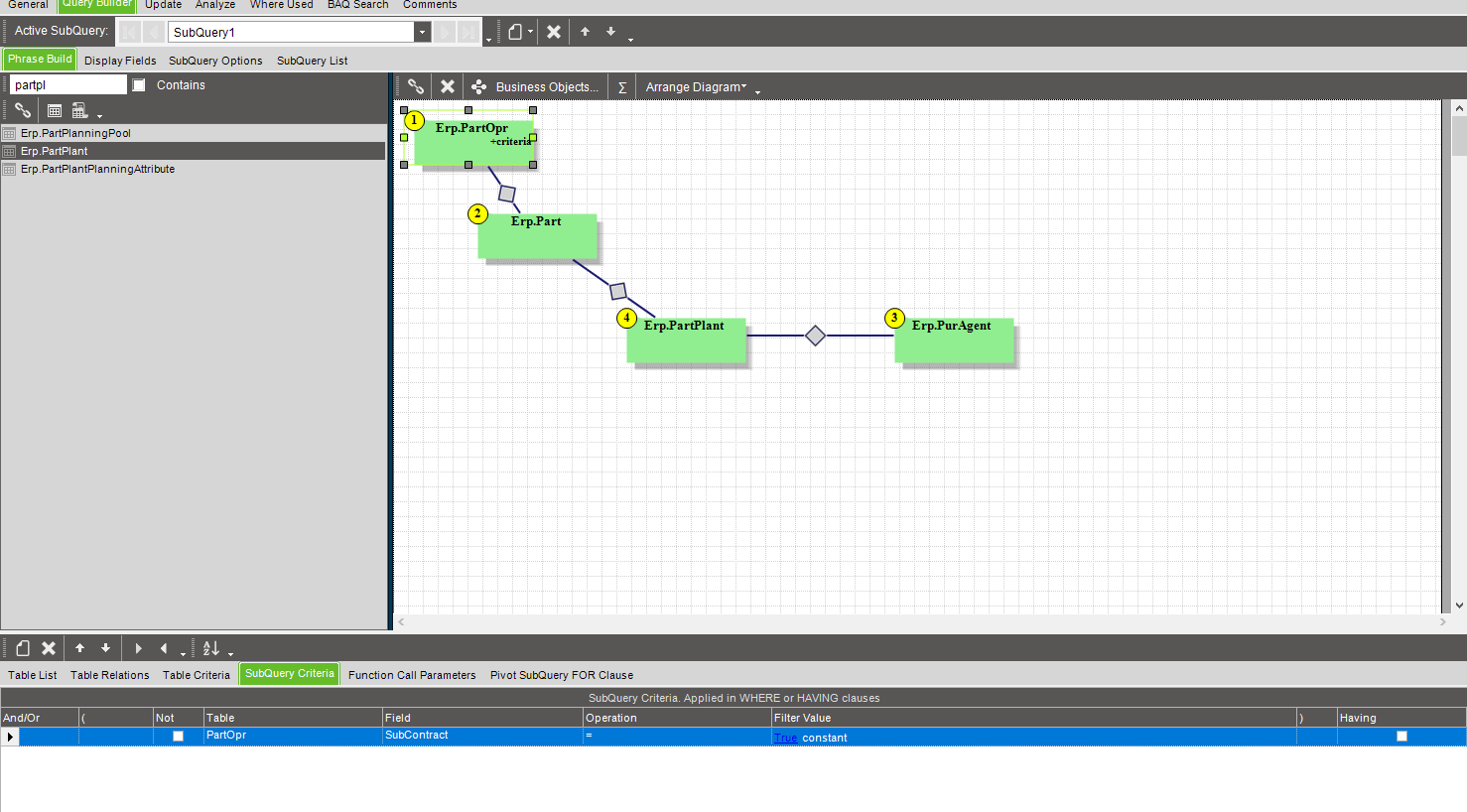

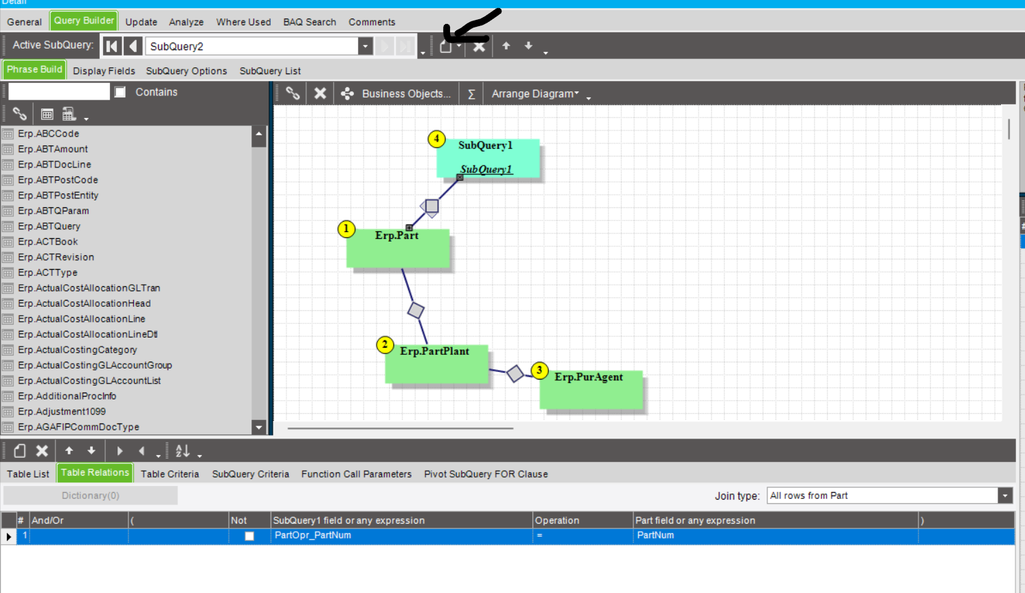

You need to add another subquery to the BAQ. Where the arrow is in the below photo. End query will look similar.

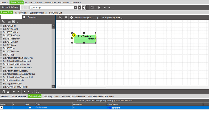

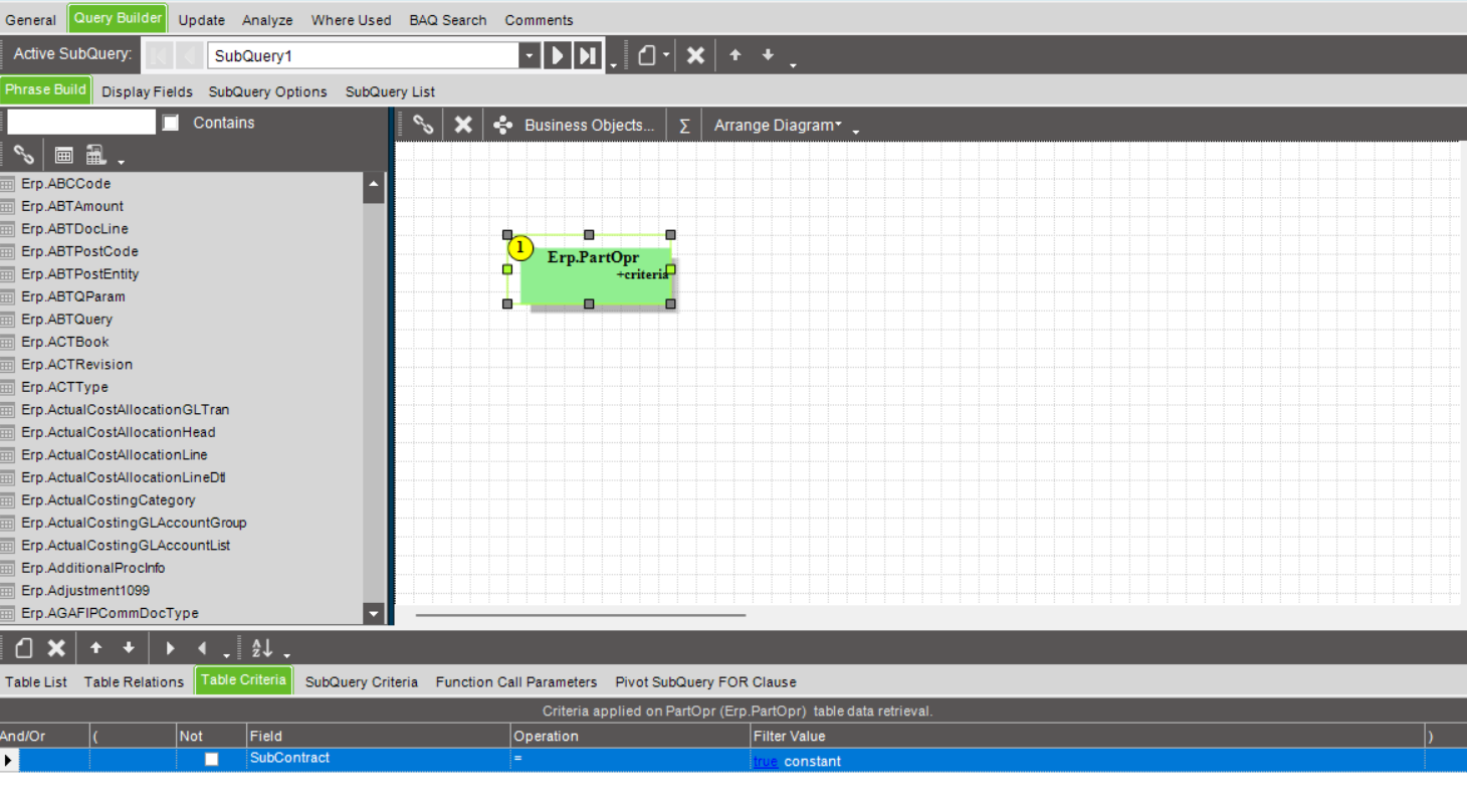

Add the PartOpr table and the criteria

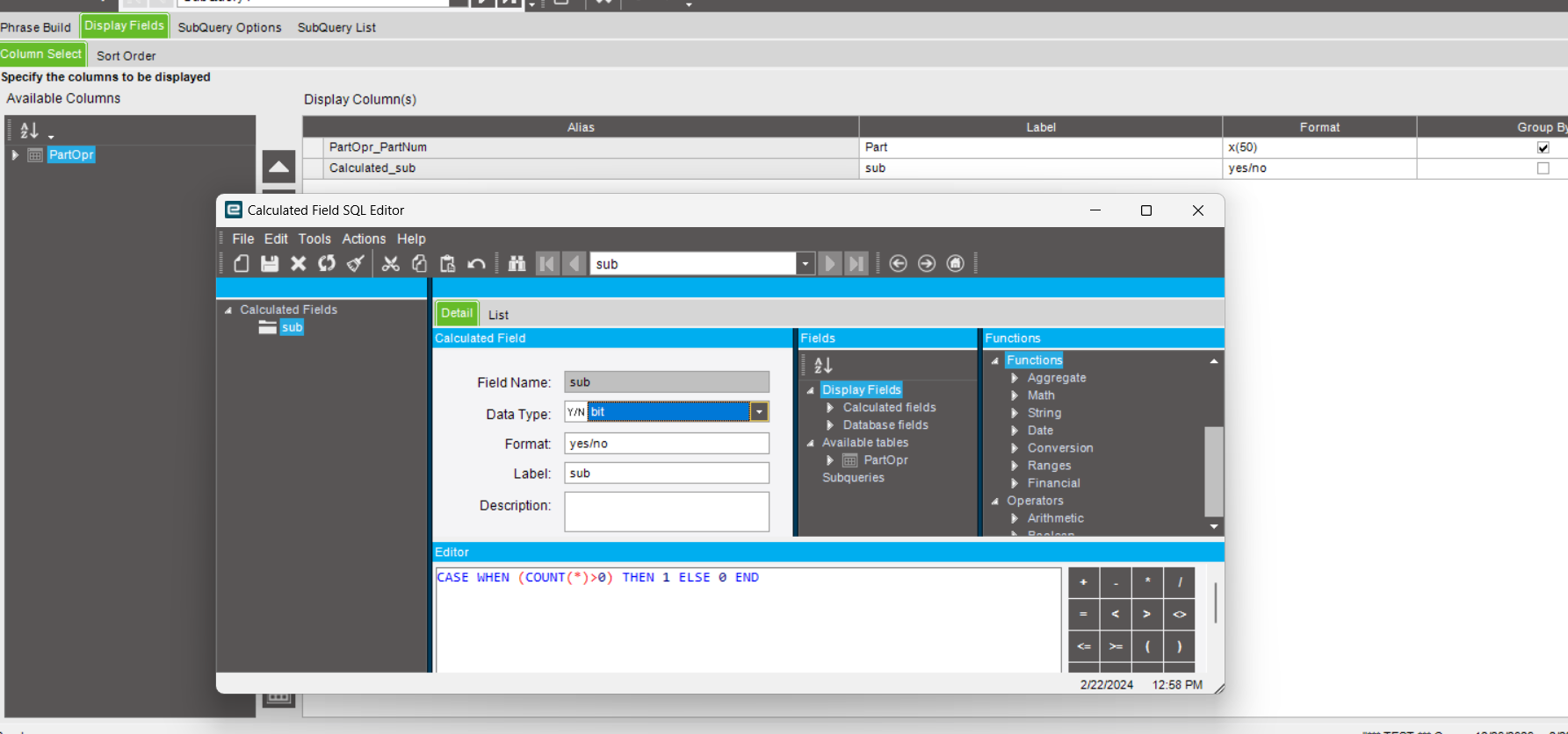

In the display fields select partnum (note the group by check box is selected)
and create a calculated field like below

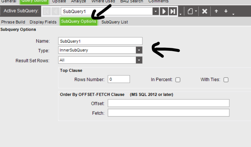

Change Subquery Options to be inner SubQuery

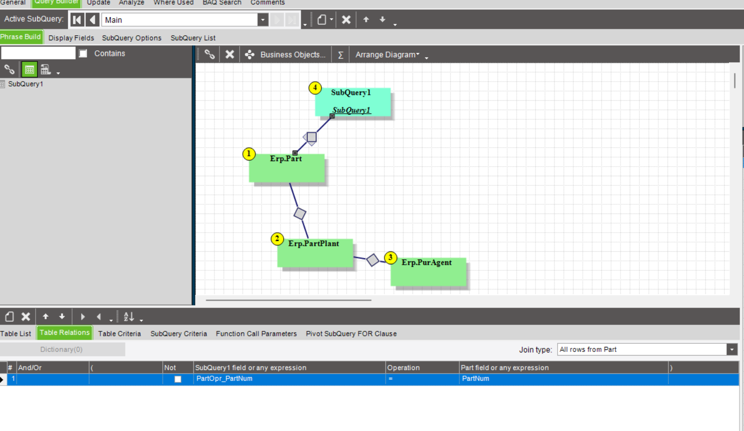

add the subquery to your toplevel query

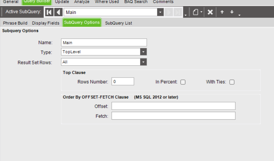

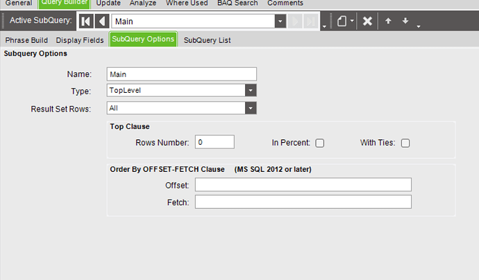

Make sure you main query type is set to TopLevel on SubQuery Options tab

The new icon in the first picture. Give it a click.
I have two SubQueries here.:
Type: InnerSubQuery
Type: TopLevel
SubQuery2 is completely empty of tables.
Here is what I have.
SubConParts.baq (24.7 KB)
Ok I managed to get a bit further. My results come out something like this though:
Updated: SubConParts.baq (42.4 KB)
Add fields from Part
That just means your Part doesn’t have an operation.
If the report is only items in subcontract, then you can make your join be an inner join; matching rows from SubQuery1 to Part as the join type.
