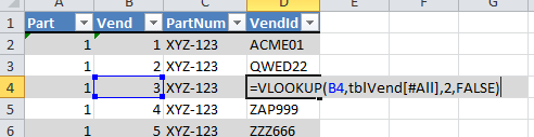

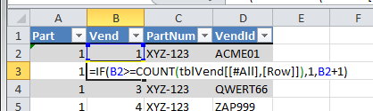

Sheet three has a row of formulas that increment the Supplier’s row num from 1 to count of suppliers, and part column row num increments every time the vendor row resets back to 1.
The third sheet the uses vlookups to find the PartNums and Vendors for the various combinations
